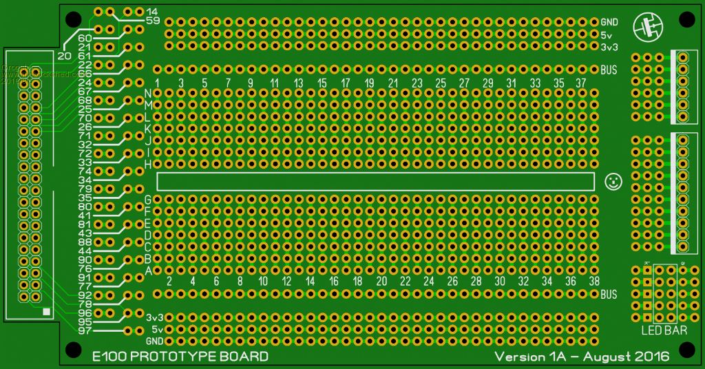

Phil23 had asked me about a prototyping board for the MM+ E100, so here it is:
This idea was all Phil23's not mine, but he is right - it may appeal to others wanting to do prototype designs with the E100 unit. Board size is 138mm x 77mm not including the area for the 2x20 connector.(150 x 77 including that bit)
I am going to do a version of this for the E64 too, but that will be published in a future thread - not too long away, a week or so probably.

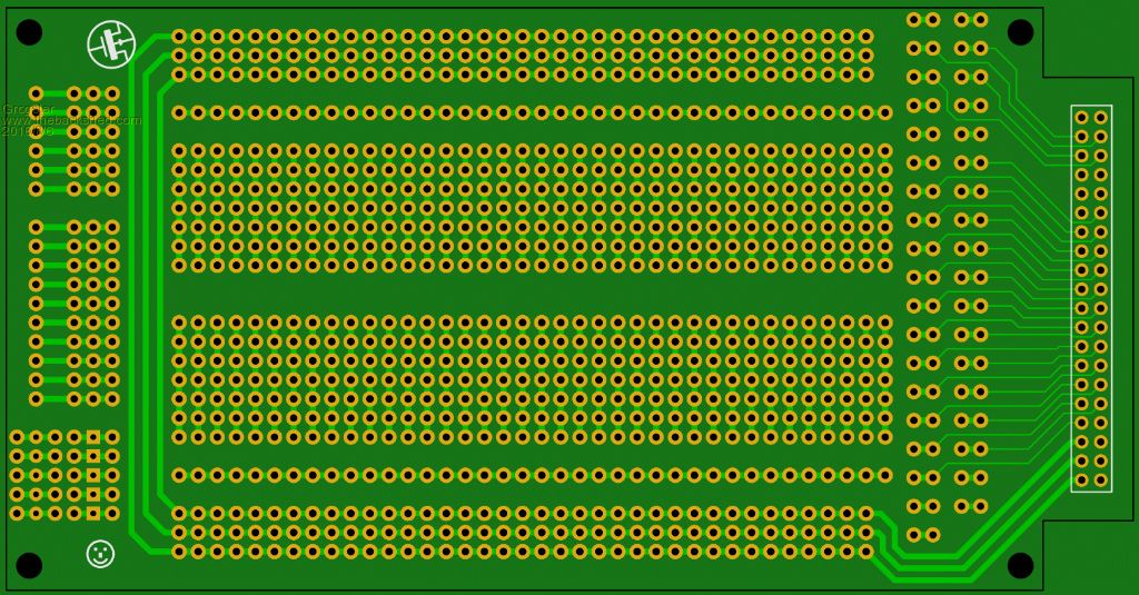

This one can plug DIRECTLY into the E100's GPIO port(CON8) via a 2x20 female header mounted on the bottom of the board, or you can also use the mounting holes and a short IDC cable(and fit a standard 2x20 box-header on the top side of the board).
It's pretty self-explanatory in arrangement, but the header sockets on the right side of the board were at Phil's request, and also there is a 5-segment LED bar-graph on the lower right of the board, for any LED's you may wish to add. You could substitute standard rectangular LED's here, if you wanted different colours, and there is provision for that under the bar-graph footprint via an extra set of holes. The gap in the middle of the prototyping area is the standard 7.62mm of all DIL IC's etc.
The pins on the GPIO port are all broken out to 1x2 pads, but not connected to any of the columns in the prototyping area. The idea behind that is so that you can configure the prototype area however you want. Routing the pins out directly to the columns on the prototype area would invariably not suit the pinout of some devices under test. Leaving this bit up to you, means you can setup the board however you want to suit anything in any pin-order. Configuration of this aspect of the design is easy-peasy: I suggest using self-fluxing enamelled copper wire on the bottom side of the board. This enamelled wire is the stuff that you just heat up with the iron, and the enamel melts, apply some solder to tin the end, and you are away.
You don't even have to do that - just cut the lengths you want, thread them to where-ever, then apply heat, wait for the enamel to melt, and apply solder and you will tin and solder the wire to the pad all in one operation. The PCB pad may not like that too much though, as you normally have to apply the heat to the enamel for a reasonable time before it melts, but whatever you are happy with....
It should be noted that some PCB houses will not let you make a board with a matrix of holes like this, because it represents excessive wear on their drillbits....

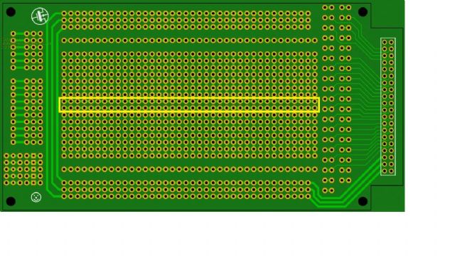

@Grogster,
Would adding two power lanes in the center be possible. There is room available.
A 3v3 and GND lane would allow for very short wires to connect power to a module/chip. As most of them are 3v3 the 3v3 and gnd combination seems nice.
You could also then very easy add little decoupling capacitors.
I indicated the area with a yellow border:

OK, yeah, I can do that - I figured the gap was a good thing, but I guess the silkscreen shows where DIL chips need to be.
With the greatest respect to all here on the forums, this is the last change I will make to this board, otherwise the design-by-committee thing prevents the boards from ever being made.
Don't get me wrong - your idea and LouisG's idea are fine(in fact most ideas are), but you have to call it at some point or you are forever changing the design to try to accomodate everyone, and the board sits in limbo while various ideas are in debate.

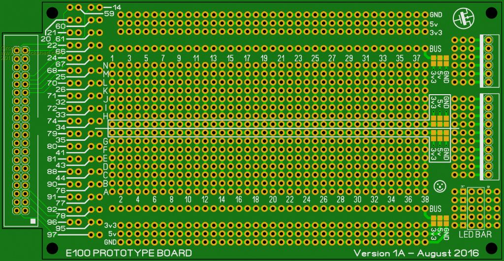

UPDATE: This is what has now been ordered.
This adds the two extra "Bus-bars" that MicroBlocks wanted, and also staggers the pin numbering to make them easier to find by running your eyes up or down the numbers.
I have also added four groups of solder-blob pads around the two new rows in the center, and also around the pre-existing buses at top and bottom, so that you can solder-blob to make these bars whatever you like - ground, 3v3 or 5v - you choose by setting the solder-blobs.
Assuming you don't change this TOO often or use too much heat when you do, the pads should not de-laminate from the board, but this is more of a "Set it and forget it" idea then one you would change often.
I think this makes it very usable - I might even use it myself!
