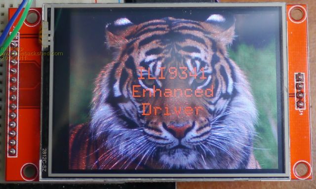

Please view the video to see what is now possible.
This loadable driver adds significant functionality to that supported by the in-built firmware and takes just 8k of memory.
It is faster: CLS takes 186msec using the in-built driver on a MX170 at 40MHz. The new driver takes 93msec
It is more colourful: The in-built driver uses RGB565 (65k colours), the new driver uses RGB666 (262k colours)
It supports transparent text and bitmaps: use 1 for the background colour and only the pixels forming the character or bitmap will be changed on the screen, the background will be left intact.
It supports reading the graphic memory: This allows rectangular areas of the screen to be saved to an array in Basic and then re-stored at a later date.
It supports outputting images from SD card on the MM2: It allows an area for writing to be set up on the display and then a byte sequence of R0,G0,B0,R1,G1,B1....Rn,Gn,Bn can be used to write full colour information to the display.
It supports writing, reading and restoring triangles to/from the display: triangles are the basis of much of advanced computer graphics. The new facilities allow things like gauge or clock pointers and hands to be written as multiple triangles with the option of overlaying the display background.

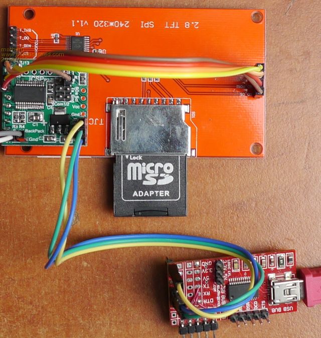

A demo program for the Micromite (MX170) is attached. This should work on Geoff's LCD backpack as well as many other boards. Note all three SPI pins must be connected (MOSI, MISO and CLK) as well as user selectable CS, Reset and D/C (may be labelled CD, A0). The demo optionally uses the SDcard to load a background image using the Micromite MX170 SD card driver
The driver will normally be saved to the library using LIBRARY SAVE and will be automatically loaded on restart. The Zip file includes both Micromite (MX170) and Micromite+ (MX470) versions of the drivers. These should work on all versions of the Micromite running 5.2 or above (28,44,64,100-pin). Also included are the picture files and a test/demo program for the Micromite+ as well as the C source.

This is my test setup using one of Mick's serial backpacks
