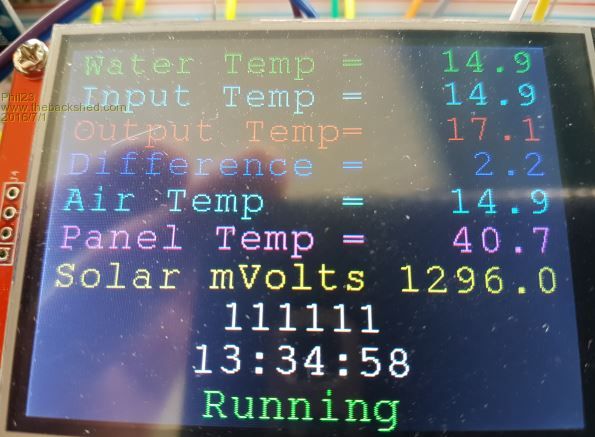

One of the reasons I decided to setup the Flags was so I could view some system status while developing the control logic.
Once I add the heat pump & motorised ball valves there will be a lot of status to monitor & observe.

Right now (7:30am) I see current temp at 13.5°C.
Input at 6.3, Output at 9.4°C, both irrelevant temps based more on ambient influence.
They require about 8-10 minutes of runtime before meaningful data is returned.
Once Solar Volts reaches 350mV there is sun sufficient to begin heating the panels.
Once the panels are 5° above water temp the pump is started.
The other situation I've observed is that when it becomes overcast, Solar volts can drop well below 350mV, yet there is still quite a lot of energy present.
Enough to keep the panel above the water temp and temp out above temp in.
