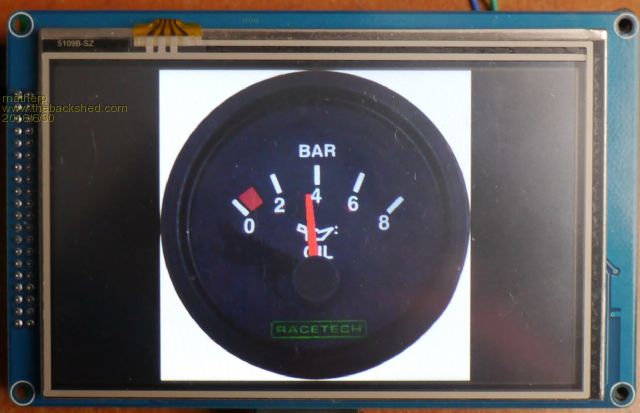

This thread tries to present fairly general purpose code that can be used to display photo-realistic gauges on a SSD1963 display. This is really the same code as presented here but I will try and explain a bit better how it works.
First things first - this only works on a SSD1963 display in which the RD pin is connected to the Micromite (like the Explore 100 )
See this live video
The program works by overlaying a Micromite generated pointer on top of an image of the display loaded from SD card.
The first 4 lines in the program define where on the display the image is to be drawn and where the pivot of the pointer is relative to the top left corner of the image
const Y_top = 0 'Y coordinate of top of the image file on the screen
const X_left = 160 'X coordinate of left of the image file on the screen
const Y_point = 320 'Y coordinate of the centre of the pointer relative to the image top
const X_point = 240 'X coordinate of the centre of the pointer relative to the image left
The next two lines allocate some memory which the CFunction will use to save the image data behind where the pointer is to be drawn. The Cfunction returns how much memory is required so start with plenty and then tune it for actual usage
const buffersize = 1000 'used to store the image data behind the pointer
dim integer buff(buffersize)
Next we need to define the pointer itself. The Cfunction works by saving and restoring triangles so in the example the pointer is constructed like this:
The following lines define the coordinates of the 4 triangles relative to the pivot. Note that I have used my photo program to get the colour of the original pointer in the image and used this so that the pointer matches perfectly. In most gauges there is some sort of round pivot to the pointer. We need to define the outer diameter of this and then we need a simple subroutine to re-draw it each time the pointer moves. In my case I've got the colours off the image and done a very simple circle with a slightly shaded edge to match the original
' Now we define the pointer as the X,Y coordinates of a number of triangles with the rotation point at 0,0
' It is simplest to define this in the 12-oclock position which means the Y-coordinates at the top of the pointer will be negative
' The order of data elements in the array is:
' t1x1,t1y1,t1x2,t1y2,t1x3,t1y3, t2x1,t2y1,t2x2,t2y2,t2x3,t2y3,...tntx1,tnty1,tntx2,tnty2,tntx3,tnty3
dim integer nt=4 'Number of triangles used to define the pointer
dim integer ptr(5,nt-1)=(-4,0,-4,-130,4,0,-4,-130,4,-130,4,0,-4,0,-8,0,-4,-130,4,0,8,0,4,-130)
DIM INTEGER pcolour=rgb(171,52,32) 'define the colour of the pointer
const pivot=35 'diameter in pixels of the pivot of the pointer
sub drawpivot() 'put anything you like here to draw the pivot as you wish
circle X_point+X_left,Y_point+Y_top,pivot,0,,,rgb(54,54,54)
circle X_point+X_left,Y_point+Y_top,pivot*0.9,0,,,rgb(43,43,43)
end sub
We now need an array to store where the pointer is currently drawn and where it is now to be drawn. As we have 4 triangles we will need 8 slots in the array for the set of 3-coordinate pairs and the colour. Processing is slightly different first time into the main loop as there is no pointer to erase so a flag is needed to remember this
dim integer xx0(nt*2-1),yy0(nt*2-1),xx1(nt*2-1),yy1(nt*2-1),xx2(nt*2-1),yy2(nt*2-1),tcol(nt*2-1)
dim integer first=1 'marker to control alternate processing on first time through the loop
The main loop starts by clearing the display and loading up the background image of the gauge
cls
load image "rtecop8.bmp",X_left,Y_top

In my example code the program just sweeps the pointer from 45 degrees left of centre to 45 degrees right. Normally of course this will be using some sort of data reading to drive the display.
' demo code moving the pointer
dim float demoangle=-45
do
do
drawpointer(demoangle)
demoangle=demoangle+1
loop while demoangle <=45
do
demoangle=demoangle-1
loop while demoangle >=-45
loop
The main processing routine is drawpointer calling rotatetriangle. This takes each of the triangles making up the pointer and rotates them about the pivot point. The code automatically compensates for the placement of the image as all coordinates are relative to the image top left. The rotatetriangle routine does the trigonometry for each triangle in turn and also stores the coordinates into the arrays which will be used in the call to the CFunction. The first parameter to rotatetriangle is the array position for that triangle (in the example 0-3). The current positions of the 4 triangles are moved to the first four array positions and the new positions are stored in the last four positions. The colours of the current positions of the triangles are set to -1. This is a coded value that tells the Cfunction to restore saved memory rather than writing a triangle afresh.
"drawpointer" tests the first loop flag "first" and only draws new triangles first time in as nothing has been stored at that point. Once the triangles have been drawn by calling "triangles" the pivot is redrawn by a call to "drawpivot"
Sub drawpointer(angle as float)
Local integer i
for i=0 to nt-1
rotatetriangle(i,pcolour,angle,X_point+X_left,Y_point+Y_top,ptr(0,i),ptr(1,i),ptr(2,i),ptr(3,i),ptr(4,i),ptr(5,i)) 'rotate the pointer into the drawing array
next i
if first then 'store the background and write the pointer
i=triangles(nt, buff() , tcol(nt), xx0(nt), yy0(nt), xx1(nt), yy1(nt), xx2(nt), yy2(nt))
print "Read buffer is ",i/buffersize*100,"% used"
first=0
else 'replace the background over the last pointer, store the background for the new pointer and write itand write the pointer
i=triangles(nt*2, buff() , tcol(), xx0(), yy0(), xx1(), yy1(), xx2(), yy2())
endif
drawpivot
End Sub

lew247
Joined: 23/12/2015
Posts: 1709
Posted: 08:53am 30 Jun 2016
That is truly amazing, and it seems to be easy to understand as well, very well documented.
I'm going to be spending quite a bit of time trying to digest how this works
It will be handy for so many things.
Posts: 2998
Posted: 09:44am 30 Jun 2016
I think you have a serious issue with the oil pressure in your car (or plane)
Seriously, I think you need to get some sleep - don't you ever stop??
This is amazing stuff. I reckon Zonker will be impressed with this (as will virtually everyone else).
Great stuff once again . . . .

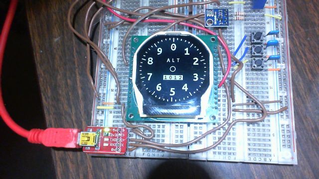

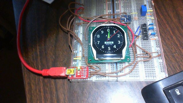

Posted: 05:08pm 01 Jul 2016
Yes Sir.. I like the awesome work Peter has done with all the different displays..!
I managed to get a week off work and will be spending some time trying to get an ALT gauge going with the BMP180 sensor that just showed up on the slow boat... Peters new driver code for the R61505V "round" displays I hope will work in the same way...
After doing the background screen layout, I hope to use a modified version of Peters "Tiny Ben" demo code to move the altimeters needles over the background screen without disturbing anything... I modified the PCB like Peter did to connect the RD pin and need to change the code to use 10 revolutions instead of 12... Maybe change the look of the needles... Still trying to understand all the usable functions inside the display driver... there could be more questions along the way... (fun stuff)..!!
Thanks again Peter for all the fine work you have done..!

@Zonker
I like your ALT gauge graphic you have there - looks very realistic from the photo
Would be good to see that working smoothly with a moving pointer and changing number.
Do keep us updated . . . .
PS - Can you link to your TFT source please! Cheers

Hey Gang...
Just an update for the ALT gauge.. The code is still very much in prototype stage, as I need to add a user interface to change the the current displayed altitude.. Currently I am using just 3 buttons to change things, but still waiting for the push button encoders to come in... the code currently changes the QNH number to effect the display...
A big tip of the hat goes to Peter M. for creating the code that makes this thing work..! He also updated the R61505V display driver code that uses the RD pin on the display that allows the needles to not disturb the gauge face.. I will be re doing the PCB's after more parts arrive... Hopefully I can group the code together and will end up with a unit that will cover 2 channels of temps (EGT,CHT,OIL,OAT) ect.. as well as a voltmeter and Altimeter... Still working on getting an RPM and Airspeed into the mix as well... Fun stuff..!! Attached the proto code if interested....
2016-07-07_121244_ALT_Gauge_test_program.zip
Posts: 2998
Posted: 02:40am 07 Jul 2016
That looks so neat - great work there by both Peter and your goodself!
Next week I am planning on ordering various TFTs for selling on the mm.org website. I would very much like to use a photo/video of your meter if that is ok. Two Q's, do you know who manufactures these round TFTs? And what is the viewing angle like on this particular TFT you are using (guesstimate of horizontal & vertical angle before 'drastic' colour change is good enough).
Nice USB module by the way

@WW...
Just got done looking at the display while running and I think it's awesome...
It is the brightest looking directly at it (well yea)... But the brightness doesn't even start to drop off until about 40 degrees..! The Color does not change no mater what angle (top,bottom or sides) you look at it..! The image displayed can still be seen all the way to about 80 degrees.. I was very impressed..! BTW- I can take a "close-up" shot(s) if needed... I would love it if you wold make these PCB's..!!
As far as price, I was getting them from AliExpress for $3.68 + shipping, so I bought 10 the last time... I read that someone said they were $9 ?? Not sure about that.. I think they can be had on E-bay as well.. (for more money)

I have also sent the "rev B" round gauge board out to get 15 made that include the RD pin changes... Attached are the updated files if anyone is interested...
2016-08-08_101308_EIS_Round_Gauge_MPU_Rev_B.zip

and has anybody found another supplier of the round LCD? Zonker's nominated supplier no longer stocks them in that size and resolution.

Yep... I found them on AliExpress and E-Bay BUT... Compared to the earlier price of less than $4.00, the new prices really SUCK..!!
"Zonker NOT happy"
Not sure what to say about all this.... Will keep searching...
EDIT: - Also at Alibaba but no price on them.. Selling in lots of ten... I have a quote in for 100...Edited by Zonker 2016-08-10

They are all 1.38", compared to the 2.2" you have now. Getting a bit on the small size for me.
