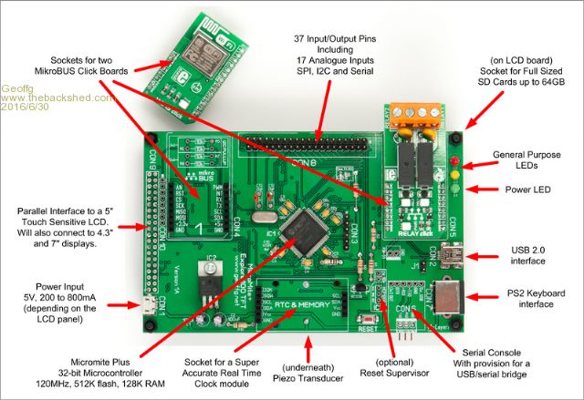

This is a heads up on the introduction of the Micromite Plus, the development of which was influenced by many here.
It will feature in three articles in Silicon Chip magazine starting with the August issue. Also featured will be the Explore 64 which most people know about and the Explore 100 which is a new board.
The Explore 100 is a 100-pin Micromite Plus on a PCB which is designed to fit on the back of a 5" LCD panel. Like the Explore 64 the PCB was designed by Grogster (thanks Grogs) and is a marvel of design being a four layer board. It has two sockets for click boards plus USB, RTC, console and PS2 keyboard connectors.
Grogster will be selling both boards on his website at: http://www.rictech.nz/micromite-products
Even better, he will be offering a version of the Explore 100 with the SMD components (there are four) already soldered and the micro programmed with V5.2. All the other components are standard through hole parts and easy to solder. So people with poor eyesight will not have an excuse!
I will update my website when I return from overseas but in the meantime I have made a video describing the MM+ and both boards. This one is shorter and more succinct than my previous effort but I still need to improve my video expertise. You can see it at: https://youtu.be/j12LidkzG2A
Explore 100 features:

Nice looking board Grogs and there certainly is a great selection of Click Boards. Looking forward to it.

Posted: 10:02pm 29 Jun 2016
Hi folks.
@ Palcal: Prior to Geoff telling me he wanted to design for those Click boards, I had never heard of them, but yeah, there are lots and LOTS of them, which is a real bonus, and should allow people to easily and cheaply expand on what the Explore-100 can do.
@ JohnS: The chip used is the PIC32MX470F512L-120I/PT.
12mm package, 100-pin TQFP, 0.5mm pin-pitch.
This board is not yet up on my website, but it will be in the next day or so.
I will be offering a blank PCB for those who want to assemble everything themselves, and a full-kit including everything to make the E100 board, but NOT the LCD, as that is something of a personal choice. The full-kit will have the SMD pre-mounted and pre-programmed as Geoff says.

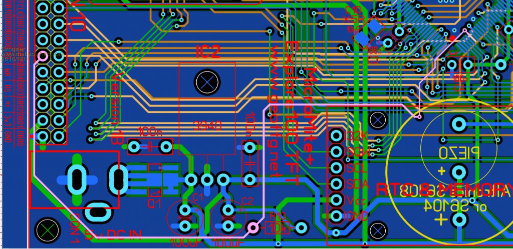

EDIT: It should also be noted that in the photo, that is the 1A prototype, and the 1B boards use a standard DC socket for the power, not a mico-USB, and also has MOSFET polarity protection. Both of those were changes requested by Geoff, and any boards I supply will be 1B's or later, so will have the MOSFET protection and DC socket......
EDIT: Geoff has authorised me to distribute the Gerber files etc, so I am preparing a package in ZIP format, and will link to this soon.Edited by Grogster 2016-07-01

I am in for your fine piece of "kit" Now we can get a stable platform to do the LCD big panel projects..! Will hit your site when things settle in... The PCB looks great..!

Nice looking board.
Am successfully using a CGColormax2 to run a small experimental process plant but have used virtually all of the available 40 I/O pins. Was hoping to upgrade to the Explore 100 for more I/O points but now see that the board only provides 37. I suppose I could glean a few more I/O from other connectors on the board. I would have thought that more I/O points would have been available for external use out of the chip’s 100 pins.

@ LouisG: You said: "I would have thought that more I/O points would have been available for external use out of the chip’s 100 pins.". The problem is that by the time you dedicate pins to the LCD, touch, SD card, CLICK modules and RTC, 37-odd is all you have left. There is one extra pin available via an extra header - Pin51, which is input only. Yes, you can use pins dedicated to the likes of the CLICK modules, by just plugging Dupont leads directly into the CLICK socket, if you are not going to populate that socket with a module. That will gain you a few extra I/O pins per CLICK socket.
