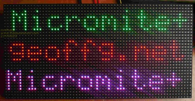

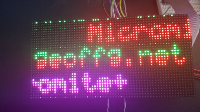

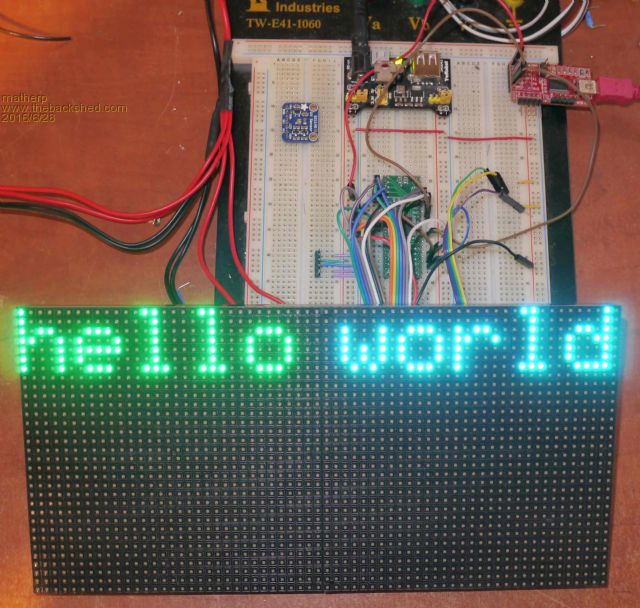

I've got a loadable driver for the 64x32 RGB LED displays like this one working (13x26cm).
This needs 13 pins to drive the display and an external 4A 5V power supply to light all pixels in white.
The driver allows you to use all the normal Micromite commands: BOX, TEXT, CLS etc. to drive the display and implements the background scanning transparently.
The driver currently implements 8 colours i.e. 3 bits per pixel but I can expand this if I optimise the code.
Let me know if this is interesting and I'll work to enhance the functionality.
Current refresh rate is 62.5FPS on an MX170 Micromite so everyone except WW should find it reasonably flicker free
I'll mock up a changing demo tomorrow to put on youtube

Posts: 12176
Posted: 12:15am 29 Jun 2016

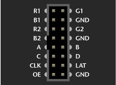

Drivers for 44-pin MX170 and 64-pin MX470 attached below. These now support RGB222, i.e. 64 colours. Coding for the colours is in the top two bits. Pinout is defined in the files. The driver uses 4K of flash memory and 6K or RAM. A driver for the 28-pin part is possible but would be 8 colour only and would still take 13 output pins to drive the display.
64-pin
Option explicit
option default NONE
' 64x32 RGB LED display driver for 64-pin Micromite
' operates in RGB222 mode
' freely selectable pins
' OE
' CLK
' LAT
' connect other pins as follows
' HA=2
' HB=3
' HC=27
' HD=24
' R1=60
' G1=61
' B1=62
' R2=63
' G2=64
' B2=1
' HA=2
' HB=3
' HC=4
' HD=5
' R1=25
' G1=26
' B1=27
' R2=36
' G2=37
' B2=38

I just ordered one of them as i have a little board with a PIC16F1559 that i need to test with this. The C-Source code will be very helpful.
Plan is to get it to work with USB and serial so it can be used both from a PC and an mcu.
Edited by MicroBlocks 2016-06-30
Posts: 12176
Posted: 02:42am 29 Jun 2016
Scrolling demo here
Simple code
Option explicit
option default NONE
dim integer i,x,a
cls
TEXT 2,16,"geoffg.net",lm,8,1,RGB(red)
DO
FOR x = 64 to -60 STEP -1
TEXT x,6,"Micromite+",lm,8,1,RGB(green)
a=4-x
TEXT a,26,"Micromite+",lm,8,1,RGB(magenta)
box a-64,22,64,8,0,0,rgb(black)
pause 50
NEXT x
LOOP

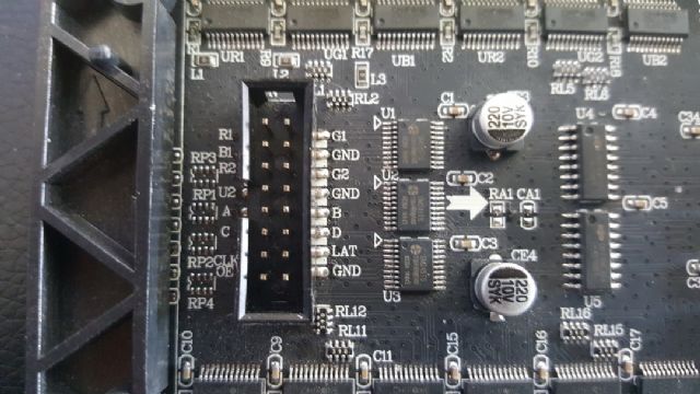

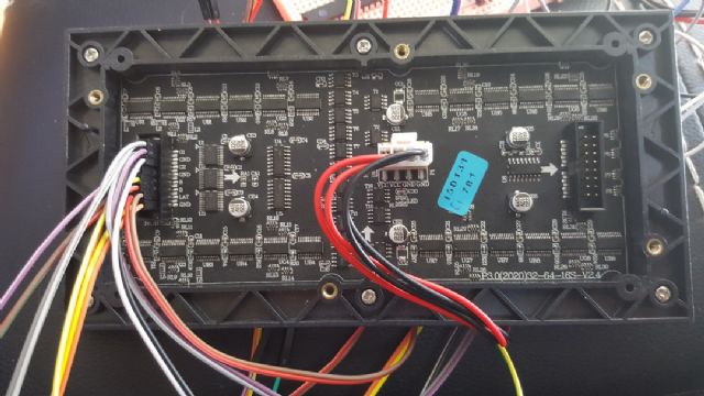

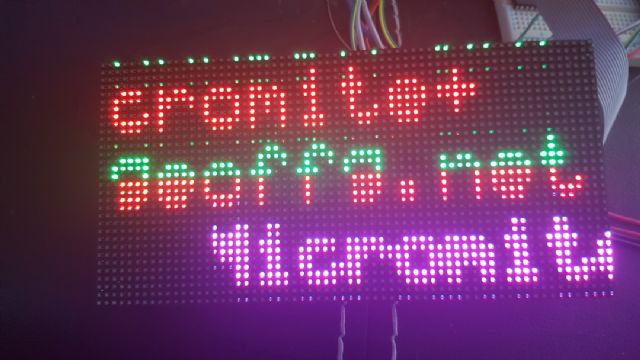

Peter I've tried this and had success but I'd like to ask some questions if you don't mind me asking.
IF I want to write to a specific section of the display how would I do it?
an example - in the middle of the display IF I wanted to have in large red letters "TOO CLOSE" and underneath it "BACKUP" (flashing) how could I do this?
Also could you explain to me how your example code works please?
[code]TEXT 2,16,"geoffg.net",lm,8,1,RGB(red)
DO
a=4-x
pause 50
NEXT x
loop[/code]
Text obviously means write TEXT what are the 2,16 on the 1st line? also the 1m, 8, 1 for?
text a?
box box a-64,22,64,8,0,0,rgb(black) I don't get this line at all, I didn't see a box.
I'm guessing for x = 64 to - 60 STEP -1 means scroll to the left 1 letter at a time?
if you wanted to scroll right would you do STEP 1?
If I want to "flash" a letter/word could I do this easily?
It would look at first if I have a slightly different version of this board than you do - looking at my display working compared to yours.
Video of mine working HERE
EDIT: I've just realised that although the code says the 1st line should be GREEN it's actually RED - no idea why
EDIT 2: I originally had the OE and GND lines reversed, put them back but it didn;t change much, apart from the "M" on the last line is a bit "funny" now
EDIT 3: Here's the pinout of my connector
Edited by lew247 2016-07-09
Posts: 12176
Posted: 02:09am 08 Jul 2016
  Quote  1st line should be GREEN it's actually RED
You have the R1 and G1 wires reversed
  Quote  Text obviously means write TEXT what are the 2,16 on the 1st line? also the 1m, 8, 1 for?
This is Geoff's standard text routine: page 21 in the 5.1 manual, probably 22 in 5.2
  Quote   I don't get this line at all, I didn't see a box.
When you scroll left to right the leftmost line of pixels is left from the previous write. The BOX command writes a BLACK area to the screen to avoid this. Try running the program with that line commented out and you will see what I mean.
  Quote  If I want to "flash" a letter/word could I do this easily?
You have to do this by writing the text out and then rewriting it in the background colour
e.g.
[code]
DO
text 0,0,"hello",,,,RGB(white),rgb(black)
pause 400
text 0,0,"hello",,,,RGB(black),rgb(black)
pause 400
LOOP
[/code]
It is probably best to do this in a SETTICK timer

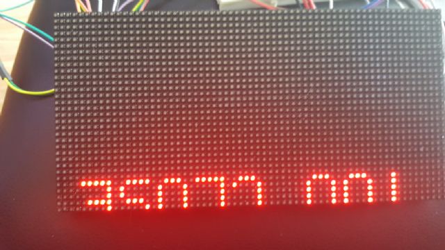

Worked perfectly after that until I tried this
[code]
TEXT 5,2,"TOO CLOSE",lm,8,1,RGB(red) [/code]
As far as I understand the manual that "should" have put the TEXT starting on the 5th LED from the left and the 2nd LED from the top?
Or have I understood it wrong?
EDIT:
I just noticed my display is upside down - the two connectors on the back, looking at the back the one on the left should be the interface to the Micromite which mine is
but the display is upside down?
I also noticed my pinout is NOT the one I posted, it has U2 instead of B2
I wonder if that is making a difference?
I flipped the display over on the short side (vertically) and the display seems to be upside dowm, or is this correct?
Posts: 12176
Posted: 05:31am 08 Jul 2016
  Quote  As far as I understand the manual that "should" have put the TEXT starting on the 5th LED from the left and the 2nd LED from the top?
You are using LM
L says left justify
M says vertical placement Middle i.e. centre the text on line 2 hence the top of the chars is missing.
Use LT if you want the top of the char on line 2
Re the orientation - just use the display the way up that works
