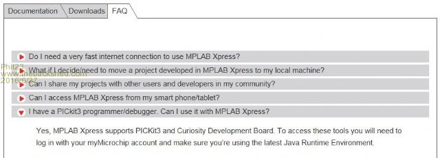

Came across it on page 11 of this months Silicon Chip.
Not sure about it's relevance here, but it did have me wondering if it provides a means of loading firmware to chips without having the full IDE installed on a PC.
Noticed "C:\Program Files (x86)\Microchip" is a Gig here, and that's not something I'd dump on some PC's just for convenience.
A brief read gives me the impression that "You File"???, downloaded to your PC, then you upload it to the device.
Make me wonder if once you have an Account, you can just log in from any PC, plug in a PicKit3, choose any local HEX file & upload it to a device.
Java doing all the work of the usual IPE

At this stage it seems like the MPLAB XPRESS only supports 8 bit devices.
There's a few mentions of full support later in 2016.
Sounds like either is a good solution.
