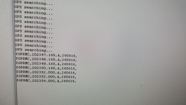

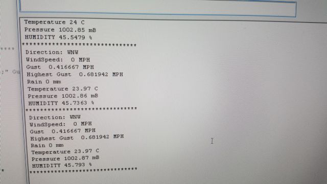

Anyone got any ideas why I'm having the problem where it won't do GPS routine and then the weather?
here's the weather routing working on it's own
and her's the GPS routine working on it's own

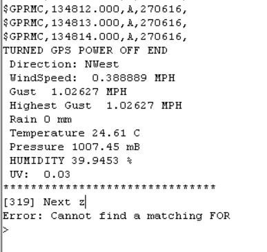

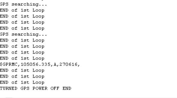

Posted: 11:17pm 26 Jun 2016
WHY isn't this working?
It does the GPS routine perfectly
It turns the GPS off after 60 seconds which is what the gps subroutines tell it to do
[quote]TURNED GPS POWER OFF END of B3[/quote]
It just won't get to the 2nd Loop which is simple a PRINT statement for testing purposes

lew247
Joined: 23/12/2015
Posts: 1709
Posted: 11:56pm 26 Jun 2016
It's still stuck
It does ALL of Loop 1 (get gps stuff) and it gets to the end of Loop 1 where it prints TURNED GPS POWER OFF END
But won't get into the 2nd Do statement/loop (print "got to 2nd Loop")
[code]Do
Do while secs < 20
GetGPSData ' get the next line
'Print "RETURNED FROM GetGPSData"
IF arg$(0) = "GPRMC" THEN ' GPRMC contains lat/long
IF arg$(2) = "A" THEN ' "A" means locked on to satellites
PRINT "$"arg$(0)"," arg$(1)"," arg$(2)"," arg$(9)"," 'Print Time and Date
ELSE
PRINT "GPS searching..."
ENDIF
ENDIF
Print "END of 1st Loop"
if secs = 15 then 'after 4 minutes
PIN(23) = 1 'GPS Power OFF
print "TURNED GPS POWER OFF END"
END IF
Loop
loop
end[/code]
Edited by lew247 2016-06-28

lew247
Joined: 23/12/2015
Posts: 1709
Posted: 01:30am 27 Jun 2016
Interesting it's stuck in a loop at Print "2"
[quote]END of 1st Loop
3: 14
2: 14
END of 1st Loop
3: 14
2: 14
$GPRMC,112939.791,A,270616,
END of 1st Loop
3: 15
2: 15
[/quote]
Edit:
Thanks everyone, got it sorted now Edited by lew247 2016-06-28

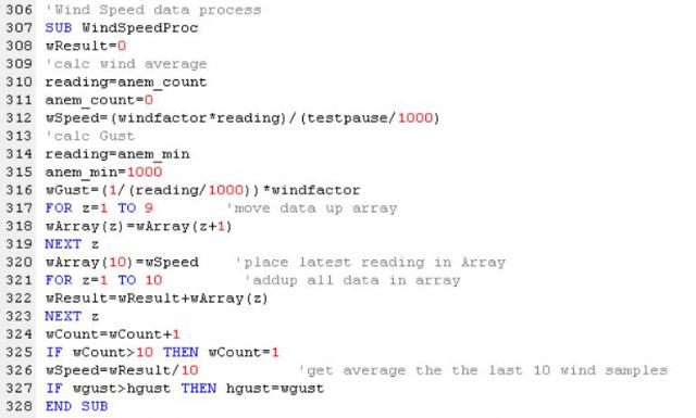

Why would a "FOR" statement not register?
a section of code (the prints are there to test where it fails)
[code]
For z=1 To 10 'addup all data in array
print "Z1"
wResult=wResult+wArray(z)
print "Z2"
Next z
[/code]
result is its adding the array up as I can see by the zA, Z1 and Z2 prints but when it gets to next z if think's there's no "FOR"
EDIT:
I only get this if I put the "turn gps on section" into a subroutine and not when it's in the main program loop
The section it fails on is nothing to do with the gps at all, it only goes to that section after the gps is turned off
Posts: 12185
Posted: 03:16am 27 Jun 2016
  Quote  think's there's no "FOR"
What version of firmware are you running? - I seem to remember this was a bug in one version but may be miss-remembering
