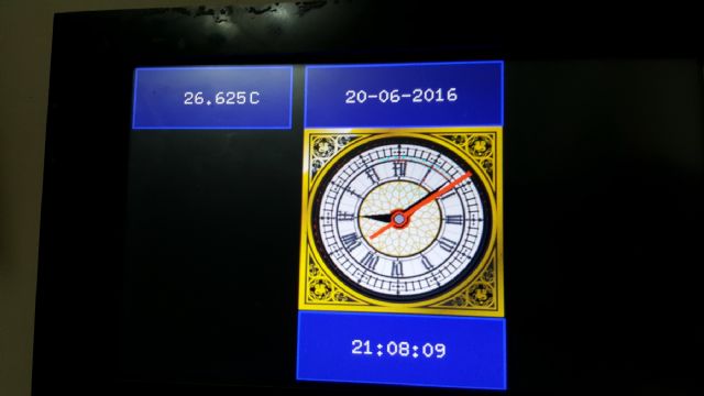

What I'm trying to do is use the excellent code Matherp wrote for displaying a clock on the LCD display with Big Ben as a background.
I have it in the centre of the screen with the clock and hands the correct size and working perfectly
The clock size is 280 X 280
I have a box above the clock and one below - the one above displays the DATE - working perfectly
The box below displays the TIME in decimal - working perfectly
The box on the upper left is "MEANT" to display the temperature from a DS18B20 and ideally refresh it every 5 seconds or so
This is the bit I am having problems with,
I can get it to display the Temp and it's fine but it updates itself every second and I've fixed the "double display/decimal point missing" by adding a new line of blank text before it updates the temperature
This "would" be fine but I cannot get it to update every 5 seconds
It updates every second and also slows the second hand of the clock slightly.
If I move the code to other sections, the clock stops working.
This is the code in case anyone would be kind enough and have a look and let me know if you spit what I've missed please

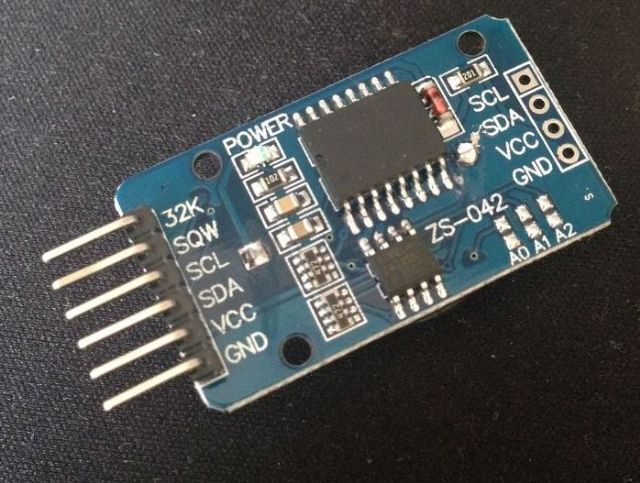

Can you explain how to use the RTC in the way you describe?
I've attached a pic of the one I have it has these 2 pins - I presume you mean using one of them?
[quote]
32K - 32KHz oscillator output. Open drain, you need to attach a pullup to read this signal from a microcontroller pin
SQW - optional square wave or interrupt output. Open drain, you need to attach a pullup to read this signal from a microcontroller pin
[/quote]
I've checked the manual and it doesn't help in this respect for newbies to programming
The only thing I found is using the RTC to update the clock every 12 hours, but I dont understand how this works?
[code]SETTICK 12 * 3600000, SetTime, 4[/code]
Obviously settick sets up a second timer but I don't get the 12 * 3600000, what it means, or the 4 at the end of the line.
This is the modification I did to get the temp working
[code]TEMPR START 18,2
Settick 1000 ,L1,1
do
secs=val(right$(time$,2))
mins=val(mid$(time$,4,2))
hours=val(left$(time$,2))
hands(secs,mins,hours,(MM.Vres\2-MM.Vres\3.87),MM.Hres\2, MM.Vres\2)
do
loop while val(right$(time$,2))=secs
TEXT 400,50, date$, CM, 1, 2, RGB(WHITE), DBlue
TEXT 400,430, time$, CM, 1, 2, RGB(WHITE), DBlue
loop
loop
end
Sub L1
secs2=secs2+1 'update seconds timer
if secs2 => 5 then '
secs2 = 0 'reset counter
TEXT 125,50, " ", CM, 1, 2, RGB(WHITE), DBlue
TEXT 125,50, STR$(TEMPR(18)), CM, 1, 2, RGB(WHITE), DBlue
TEXT 185,50, "C", CM, 1, 2, RGB(WHITE), DBlue
endif
End Sub [/code]
Edited by lew247 2016-06-22

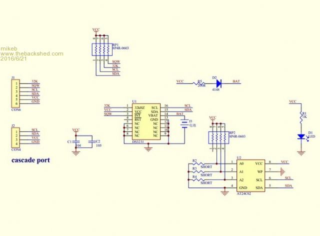

I've got 10 of those RTC modules. The first thing I do is remove the diode (D2) and 200R (R5) resistor (next to the SCL pin). Lithium 'coin' cells are not designed for recharging . Check on the web and find how many people are surprised that the cell ends up bulging. Particularly if the device is used at 5V. (Vmax 5V5).
The RTC is an I2C device so you need to connect to the I2C peripheral of the MM.
As you are using an SSD1963 you must have an MM+ so connect the SCL pin to pin 44 and the SDA pin to pin 43. Connect Vcc to +3V3 and use a pullup resistor (4k7) from pin SQW to Vcc. Thie SQW pin can be connected to any free digital input.
I'm not at my design PC at the moment so can't give you, exact, working examples to follow. Have a look through Geoff's really great manuals for usage of interrupt (otherwise just branch on change of secs variable and forget SQW),
RTC GETTIME and RTC SETTIME.
By default the RTC has a SQW frequency of 8.192kHz (not very useful) so you have to write to the configuration register (0Eh) and set bits 3 and 4 to 0.
If you haven't already download a copy of the DS3231 datasheet. Tried to upload but it is too big.
For now it is probably easiest for you to get rid of your 'DO ....WHILE' loop
and do an IF.....THEN. IF seconds has changed THEN update your time and temperature variables, start another conversion and write your new data to the display ENDIF go and do something else.
Lose the TEMP START command at the top of your program otherwise you may execute it inadvertently. It just means that the first second after power up you won't do a temperature conversion.
Do you really need the 5 sec delay between conversions ?
