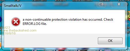

Figured I'd load MMedit on my Office PC, yesterday.
Didn't have any luck.
Returns this error when I try & launch it.
Attached is the contents of AppData.....
Removed the help file so it wasn't to big to upload.
Phil.

Phil,
This is the standard reply I give for this error message:
  Quote  A non-continuable protection violation is Windows' way of protecting us from rouge software and to make life difficult for program developers.
Visa made the setting too tight but they relaxed things a bit for Windows7.
My W7 had the default setting and all is well but some PC suppliers had things set tight.
You can either change your settings or install MMedit into a folder that is NOT in 'Program Files'
Please check you DEP settings and if is not set to essential Windows programs only, that is the problem. If you want to leave it set for all programs you can add MMedit as an exception or go the other folder method.
The easiest way to find DEP is to search Windows Help for DEP.
DEP stands for Data Execution Prevention.
I did add a "manifest" which is supposed to stop this from happening but as you have seen, Windows wins the battle some times.
It has worked every time so far...
For the record, what version of Windows?

  TassyJim said   Phil,
Sorry Jim,
Intended to add that, W7Pro SP1
I'm familiar with DEP
Phil

DEP Exclusion fixed the laptop issue.
Cheers.Edited by Phil23 2016-06-17
