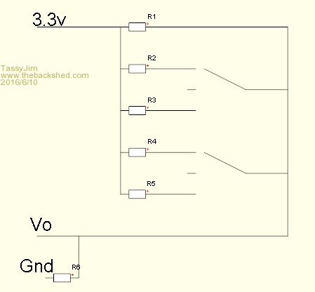

I think this is what you are after
With the correct values, you can cater for all 9 possible combinations.
These values (in k ohms)
R1 100
R2 22
R3 2
R4 10
R5 1
R6 1
gives
2.856018883
2.972972973
2.049689441
3.126614987
3.267326733
2.185430464
1.605484299
1.641791045
1.314741036
these 9 voltages.
There will be better choices of resistors.
Open circuit cable gives 0 volts.

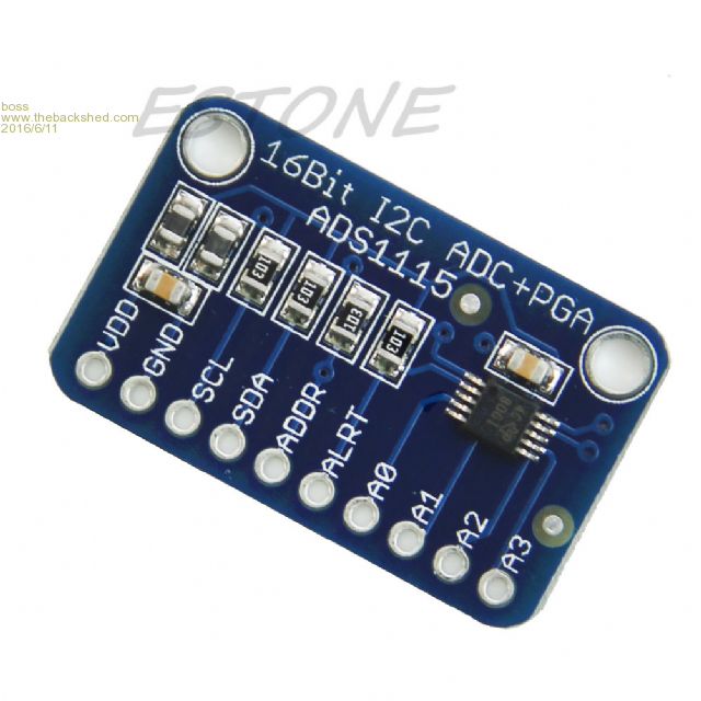

try this
ADS1115 4x 16bit A/D, I2C, ~$3.50 on Ebay.

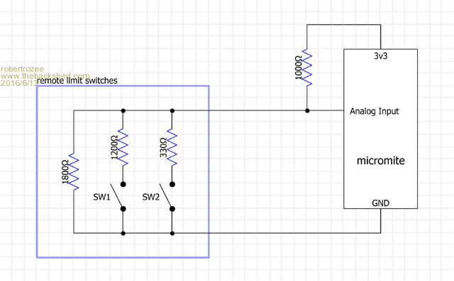

regarding the original question: motorized valves with limit switches (2 per valve), with approx 10 seconds between limits while valve is in transit; i'd suggest the following:
with both SW1 and SW2 open, about 2.1v will be present at the analog input, with SW1 closed there will be about 1.4v, with SW2 closed there will be about 0.7v. under fault conditions of the wiring from the micromite open-circuit there will be 3.3v at the analog input, while a short will result in 0v. these voltages are what the micromite 'believes' are present, and are independant of Vcc. no external reference or precise Vcc should be needed.
the wiring 'cost' is a twisted pair to each valve, and 1 analog input pin per valve on the micromite. i would recommend against trying to encode more than a couple of switches per analog input.
it is also a very good idea to have the motor travel shut down by a seperate set of contacts on the limit switches - i presume this is built into the motorized valve design? another safety feature is to monitor the motor current.
the below spreadsheet contains the resistor value calculations:
2016-06-13_121906_resistor_values.zip
rob :-)

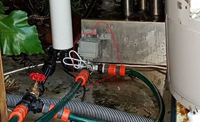

At this point now; motorised ball valve installed.
Courtesy of Teenager on School holidays...
It's 12V DC, polarity reversed to change direction.
SPDT limit switch.
  robert.rozee said   regarding the original question: motorized valves with limit switches (2 per valve), with approx 10 seconds between limits while valve is in transit; i'd suggest the following:
with both SW1 and SW2 open, about 2.1v will be present at the analog input, with SW1 closed there will be about 1.4v, with SW2 closed there will be about 0.7v. under fault conditions of the wiring from the micromite open-circuit there will be 3.3v at the analog input, while a short will result in 0v.[/quote]
Just wondering what values to test for as far as tolerances are concerned?
3.3, 2.1, 1.4 & 0.7 +/- how much?
[Quote]The wiring 'cost' is a twisted pair to each valve, and 1 analogue input pin per valve on the micromite. i would recommend against trying to encode more than a couple of switches per analogue input.[/quote]
That's what I'm planning, 1 valve per pin. Avoid the encoding of multiple valves.

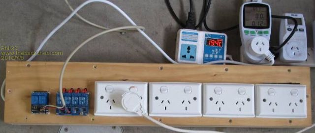

Was planning on powering the valves from a 12V plug pack that's only powered when the valves need to be changed.
The control board contains 6 relays, all SPDT.
4 Switch 240; Circulation Pump & Heat Pump compressor.
2 will be required to supply & reverse power to the ball valve.

Posted: 02:22am 06 Jul 2016
use something like this:
setpin 2, AIN
do
v=pin(2)
if v<0.4 then
print "short to ground"
elseif v<1.1 then
print "SW2 closed"
elseif v<1.8 then
print "SW1 closed"
elseif v<2.7 then
print "both switches open"
else
print "open circuit"
endif
loop
note that the case of both switches being closed at once is not distinguished from just SW2 closed, but this situation could only occur if there was a mechanical failure in one of the switches.
rob :-)Edited by robert.rozee 2016-07-07
