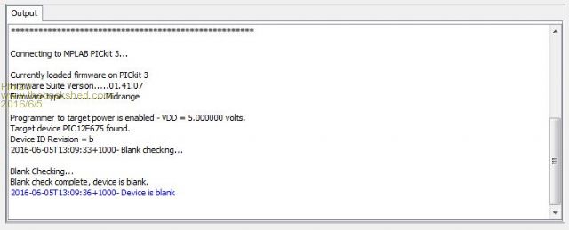

Phil23
Joined: 27/03/2016
Posts: 1667
Posted: 05:13pm 04 Jun 2016
Finally got to check this out again on a rainy day......
No Wonder it doesn't work......
I'm sure I'm reading it correctly.
Cheers.
