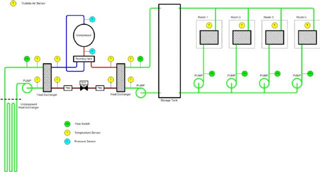

Hi Paul,
I think I've got the included drawing right based on your functional descripton.
My background is refrigeration, air conditioning and building management systems.
Definately two MM+'s with 7" touchscreens. One for the left side of the storage tank and one for the right side. Right one could have RTC, for time scheduling, an SD card for data logging and an RF module to suck out the data, probably in csv format ready to slot into an Excel spreadsheet. If your data is setup correctly in an array it will be a simple matter to transfer the array from the left MM+ (condensing unit) to the right MM+ (indoor coil control) onto an SD card and then on to your PC via RF. The right MM+ would also look after the room Temp sensors and associated coil pump control. I can see the graphics now !!!!!
The left one would look after the condensing unit. I would start and stop the unit based on the temperature of the water as indicated by the sensor located between the storage tank and the heat exchanger pump (bottom of tank in drawing). The condensing unit would not be allowed to start until the flow status of BOTH heat exchanger pumps was proven. Would recommend flow switches for this task. I would ditch the expansion valve if you can, and fit an electronic expansion valve, that way you could precisely control superheat. Cheap stepper motor drivers are readily available (do a search for Pololu) and could be hooked up to a PWM output, or pulse an output in conjunction with an interrupt, of the MM+ to output the desired number of pulses required to maintain superheat. You'll notice I have included enough temp\pressure sensors to achieve this. Otherwise keep the TXV but the sensors are probably still handy. The pressure sensors could provide for high, and low, pressure cutout. Likewise for the Temp sensors. Setup a serial comms link between the two and you'll have your very own BMS. Geoff has included enough interrupt sources to do ALL that you require......and some.

Hi Mike,
Thanks for your reply. Your drawing is almost exactly what I'm dealing with and your suggestions are well thought out.
I really don't want to open up the freon system again. I had to replace the reversing valve several years ago and it was a hassle to pump it down again. I doubt that I will switch to an electronic expansion valve. I have measured the evaporator superheat several times and it is always about 12°F so I think the TEV is functioning well.
I would like to be able to measure the freon pressures but I have been unable to find pressure transducers which seem reliable and accurate. I think that observing the temperatures into and out of the compressor will probably suffice.
The Copeland scroll compressor has internal high and low pressure limit control so I'm not worrying about the compressor being damaged. I'm also not too worried about slugging liquid into the compressor since the scroll design is inherently resistant to damage from liquid ingestion.
My principal worry is preventing sudden freezing of the plate type exchangers.

Hi Paul,
My suggestion for the RF module (bluetooth, wifi, whatever) was purely for getting logged data, from the MM+, onto your computer. I would definitely set up a hardwired RS485 serial connection between the to MM+'s. I envisaged one of the touchscreen\MM+ combinations to be inside the house.
Looking at your pipe sizes a DP switch across the pumps would definitely be the go.
I did a lot of compressor retrofits in a data centre a while back. The failure mode, due to liquid floodback, was a destroyed 'top end' bearing due to the liquid washing out the oil in this bearing.
You could indeed do the whole installation in one MM+. I just like the idea of a touchscreen, for users, inside the house and a touchscreen at the equipment which is likely somewhere else.

Hi Paul,
The problem won't be running out of internal resources, program\variable space, interrupts etc, but running out of external I|O pins. The MM+ is more than fast enough to do what you want.
If you split your system up down the middle of the storage tank then you can logically divide it up.
Your condensing unit side MM+ needs to know too things from the other side -
when to run and what temperature water to supply.

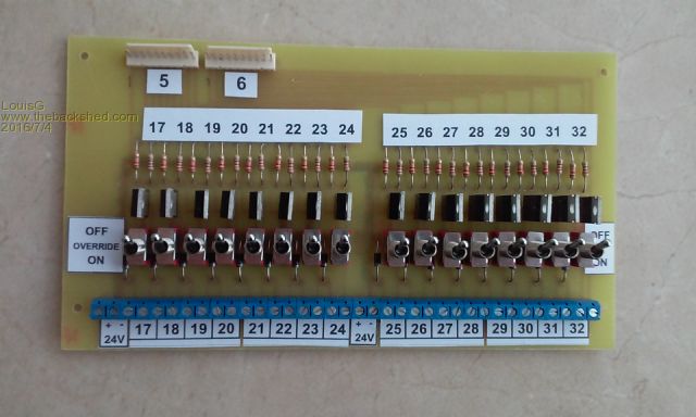

My suggestion, do not sandwhich the lot. My understanding is you may have plenty of room for an indutrial greade box.
Have a basebord pcb where your modules plug in, this way you have easy access to replace any module you like.
Input/ouput connectors to be placed at the edge of the board. Swing out cover/door where you mount what you need.
Don't make the box too small , you want to have access for the electrician or yourself to be able to trouble shoot, probaly with a small laptop sitting on a swing out shelf.
On the base board (make it a big pcb) which should hav suitable number of isolation links, these really can not be decided until the complete circuit diagram available
Have spares of everything, including the base board, which with a complete set of spares fitted can be used for trouble shooting a problem off line if need be. You can replace the whole working back board at least get running again.

It sounds like you want me to go back to wirewrapping the backplane main frame for an IBM 360 with its plug in modules. I agree that it would make troubleshooting easier and replacing failed modules easier, but I'm reluctant to spread the thing all over a square foot of real estate. My quarter century of experience on Boeing aircraft tells me that most of the problems that develop from modern solid state gizmos come from the interconnections and wires.
I'm trying to keep it as compact as possible. If it turns out that the sandwich stack is impractical then I'll have to figure out a horizontal assembly with boards next to one another, but I don't think I'll go as far as a big mother board. I assume that's what you mean when you say "baseboard". What is a "baseboard" in OZ speak?

I wouldn't use a 'sandwich' construction as it is far too difficult to fault find.
Surely you have space to use a bigger enclosure.
Have you drawn this project concept out on paper or are you working from your
head ? A picture is worth a thousand words.
If you would like to send through a rough layout of your installation, and a desired I\O list, I can help you with a drawing and system design concept.
I do not profess to have all the answers, when it comes to programming, but I have a good understanding of MM resources, and system requirements, to help you with a 'functional, and serviceable, system design.
