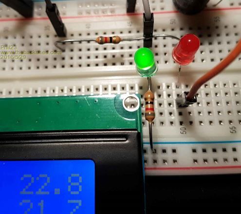

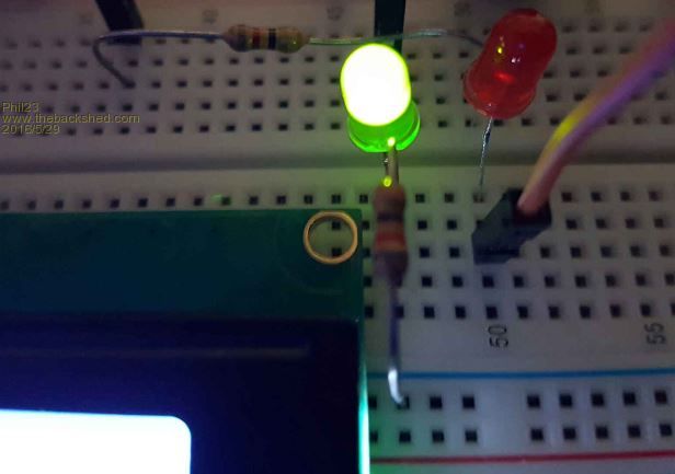

I see many threads where people try to show photos of devices with LEDs that don't nearly show the true colours.
The LED's intensity is blowing out the camera sensors highlights.
There is a simple solution.
Just illuminate the subject a bit more, generally with some white background present.
The result:-
This, under normal lighting,
Compared to this, with just a 5W reading light over the subject.
Both just taken with my phone.
Phil.
