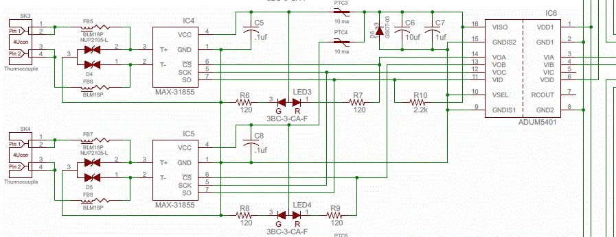

The IC's need to be isolated so the internal tests done by the MAX 31855's will pass ok...
The end user will try to ground the "hot" side of the sender when being used as a CHT probe...
I can't seem to find any isolated CHT type probes.
They all seem to crimp into a LUG that fits up to the spark plug on the engine.....
The EGT ones seem to be isolated ok...
The chip checks for a grounded or supply tided probe condition and has error bits for it...
So, I figure something like this may work ok..
This type of ISO chip also supplies power for the converter IC's....
I can even check if "power is ok" from my end..
On the larger system, I will be using the LTC2983 IC, which uses a deferential type setup, and doesn't need the isolation...
