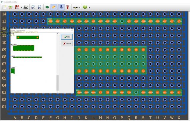

Phil23
Joined: 27/03/2016
Posts: 1667
Posted: 02:15am 28 May 2016
Look's like a great concept for lots of users who aren't into PCB design.
Will get my hands on a couple when they are available.
Especially like the ability to play with the layout in software, even though I had to use 2 DIP14's to represent a MicroMite.
Any Idea when they will be available?
And DIP28 added to the component library?
Phil.
kiiid
Joined: 11/05/2013
Posts: 671
Posted: 02:40am 28 May 2016
You can actually define your own components.
Select the component mode (the orange icon), right click and select "Add New Component". Then choose the one on top which says "BLANK", give it a name and place the holder somewhere on the board. Now you can add and remove pins within the component area, and you can drag the pins to change the component area. So you place 28 pins, give them names or numbers and then when ready right click again and choose "Add to Library".
http://rittle.org
Phil23
Joined: 27/03/2016
Posts: 1667
Posted: 02:49am 28 May 2016
Ahhh,
Thanks, didn't know the usage & saw that add to library was greyed out, so thought it wasn't implemented yet.
Phil.

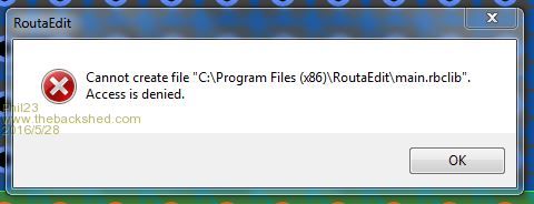

Phil23
Joined: 27/03/2016
Posts: 1667
Posted: 03:05am 28 May 2016
Error on add to library.
NTFS file permissions on C:\Program File(x86)?
Not usually writable by default,
but strange as I have full permissions to the file and have ownership.
Phil
kiiid
Joined: 11/05/2013
Posts: 671
Posted: 03:27am 28 May 2016
Looks like that. Try to run the program as administrator
Will be fixed in the next revision
http://rittle.org
Phil23
Joined: 27/03/2016
Posts: 1667
Posted: 03:31am 28 May 2016
That's what I'd just been trying.
Worked fine.
