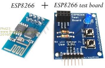

Reason I ask is I have this board:-
The two switches on it pull Reset & GPIO0 low.
It seems unfeasible to be holding the GPIO button down for the entire flashing process.
Just doesn't make sense to have a momentary switch if in reality a latching one is required.
Holding it down while pressing the reset "Seems" to result in successful flashing, according to the flash logs.

Update:-
Just tried flashing an unused ESP8266 with this board & all went successfully.
Seems GPIO0 only needs to be held low on reset to enable programming mode.
Also my original module now seems unrecoverable.
