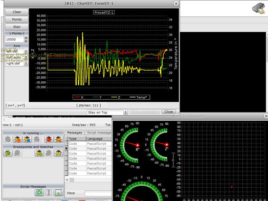

Hi to Everybody
That mine is a curiosity. Because, arduino has a resolution of 1ųsec regarding servo command. And my client wants to use 24 precise servo. I am creating a mini PCB which which control 1..4 servos, 1 RTC, 1 WIFI, 1 MPU9250. PICs/MMBasic communicate in real time in wifi with our Microsoft Azure Cloud service, the PICs will be connected in real time in live TCP for exchange data and distributed processing ... first IoT with MMBasic
