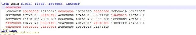

Ok, colors--thank you.
The only thing that jumps out at me initially is that in CFunctions, some of the numbers display in red and some in black.
MMEdit does the same, but different numbers are red. This is of no consequence to me.
I use npp a lot, so thanks for this.
Lance
Edited by lizby 2017-05-10
Posted: 03:09pm 09 May 2017
That is something that is difficult to do anything about.
NPP looks at a 'word' and if it only contains numerals it is a number.
Added to that it can contain a sign '-' e for exponential and still be a number.
Depending on the lexer, HEX numbers will appear as a number but they usually need &h, 0X etc
In MMEdit, if the 'word' starts with a numeral it is treated as a number.
This means that a variable such as 1X will display as a number but X1 will display as a word.
The only way is to turn off colouring at the start of a cfunction and back on at the end.
That requires greater control of the Scintilla gadget that is doing the hard work.

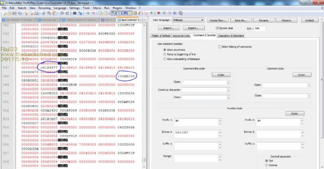

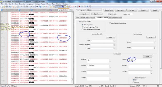

  lizby said   Ok, colors--thank you.
That seems to be related to the "Prefix 2" in the numbers definition.
See in these examples, adding 0-F in this field should fix that bit.
Dunno if it will break it else where.
Phil.
Phil23
Joined: 27/03/2016
Posts: 1667
Posted: 12:31am 10 May 2017
Not really readable above, but Prefix 2 needs:-
0 1 2 3 4 5 6 7 8 9 0 A B C D E F
In the above example I just added C & 1 after the &H for a test.
Phil

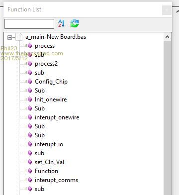

Really Don't understand the XML here, but getting this result...
Notice it's picking up the End Sub & End Function words....
this is the Parser I'm using, wbut it's a bit out of my depth.
[Code]<function mainExpr="((SUB|FUNCTION)).*?(?:\(|$)" displayMode="$className->$functionName"> [/code]
Can anyone tell me how to make it ignore the END SUB & END FUNCTION lines?
This is the entire functionList.xml I'm working with ('we are hacking a VB section pasted near the end).
Would be great if someone could help out in getting the last step.
Phil.
