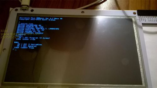

and what I'm wondering is whether it is possible to use the Micromite as a "primary" display, or otherwise simulate it? I saw kiiid's "MM+ school laptop " which appears to be doing what I have in mind:
but I'm not sure if that's e.g. hardware VT100 or VGA or ... ? If there's no straightforward solution, is there a way to "emulate" console functionality e.g. using an "exec"-type command to run BASIC commands from within another program that handles the UI, i.e. something that looks like this:

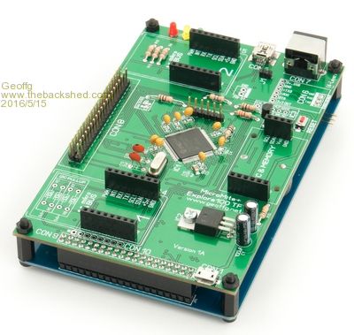

If you want to have a self contained computer then you have to use the Micromite Plus (MX470 chip).
Grogster has designed a backpack like PCB for the MM+ designed to fit on the back of a 5" SSD1963 display. This includes a keyboard interface so the whole thing can act as a self contained computer with SD card storage. I am currently writing an article describing it and it should appear in Silicon Chip (an Australian magazine) in a few months. This is a sneak preview:
Kon's School Laptop uses the same chip but is more sophisticated.
