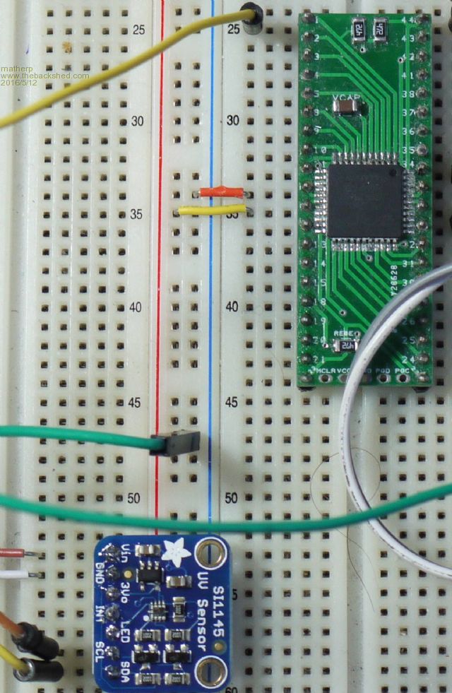

At lew247's request here is a simple 1:1 port of Adafruit's code for the SI1145 Digital UV Index / IR / Visible Light sensor

lew247
Joined: 23/12/2015
Posts: 1709
Posted: 11:47pm 12 May 2016
Thanks :)
Hopefully I'll be able to sort it out myself from now on
