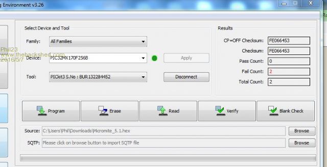

Hmmm,
Not getting a result yet.
Any suggestions on this error.
Connecting to MPLAB PICkit 3...
Currently loaded firmware on PICkit 3
Firmware Suite Version.....01.41.07
Firmware type..............PIC32MX
Programmer to target power is enabled - VDD = 3.300000 volts.
Target device PIC32MX170F256B found.
Device ID Revision = A2
2016-05-07T22:09:09+1000- Programming...
The following memory area(s) will be programmed:
program memory: start address = 0x0, end address = 0x3ffff
boot config memory
configuration memory
Device Erased...
Programming...
Failed to program device
Selected device and target: memory mismatch.
2016-05-07T22:09:15+1000- Programming failed
Pass Count: 0
Phil

It happens whenever the programming pins are (excessively) loaded by other devices/components than the PICkit: are those (pin 4 and 5) connected to anything but a 2K+ resistor or other IC input pin (especially capacitors, low impedance loads such as a LED, another IC output pin, etc) ?...
If the answer is yes, then you can't program the PIC in-circuit unless you can disconnect the offending load (I usually use the MM pins 4 and 5 as outputs, or connected to a load that hooks to the board via a connector, and can therefore be disconnected during reprogramming of the PIC).Edited by piclover 2016-05-08

Posted: 10:49am 07 May 2016
  piclover said   It happens whenever the programming pins are (excessively) loaded by other devices/components than the PICkit: are those (pin 4 and 5) connected to anything but a 2K+ resistor or other IC input pin (especially capacitors, low impedance loads such as a LED, another IC output pin, etc) ?...
It was just a bare MX170 plugged into a bread board & connections to the programmer made with 10cm jump leads.
Absolutely no other components.
I was powering it from the Pickit3 with the "Power Target from tool" option,
and it seems that was the issue.
Plugged a 3.3/5.0 volt module in and it programmed fine.
Thanks.

Posted: 08:26pm 07 May 2016
You still need a capacitor on the VCAP pin.
Having a more powerful power supply can mitigate the need.

Hi Phil,
I was about to reply to power externally with 3v3.. but I see you have worked it out (deselect power the device though so there is no problem with two power sources fighting each other...
I have only ONCE got a NanoMite to program using the PK3 power source..
But mine is a clone. Maybe the genuine PK3 is better in that regard.
I now always supply external power..
Kind Regards,

Until i made my own programmer i always used the PK3 to program the chips directly.
I put a ZIF socket on a piece of board and only connected a cap on the VCAP pin.
Without the cap, 80% failure, with it never a failure.
Once in a circuit things can get more difficult. A cap/diode/resistor on one of the programming lines can really mess things up. With the PK3 you get a poster that has the requirements on it.
Follow that and no problems.
