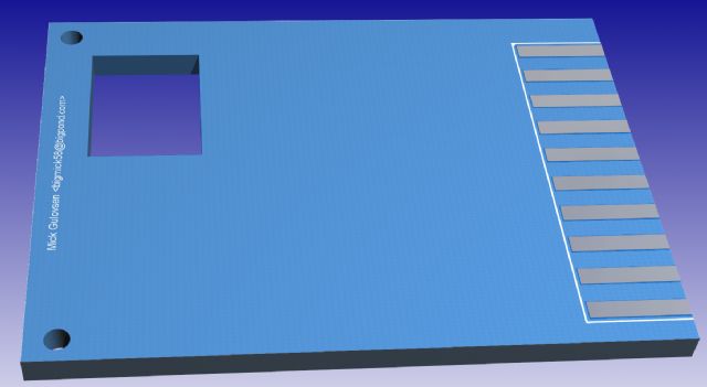

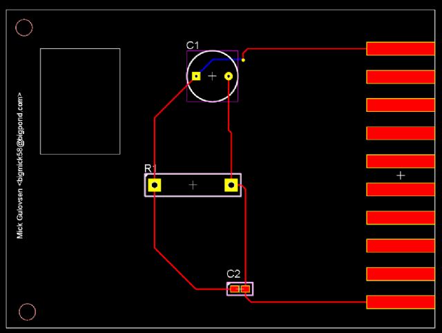

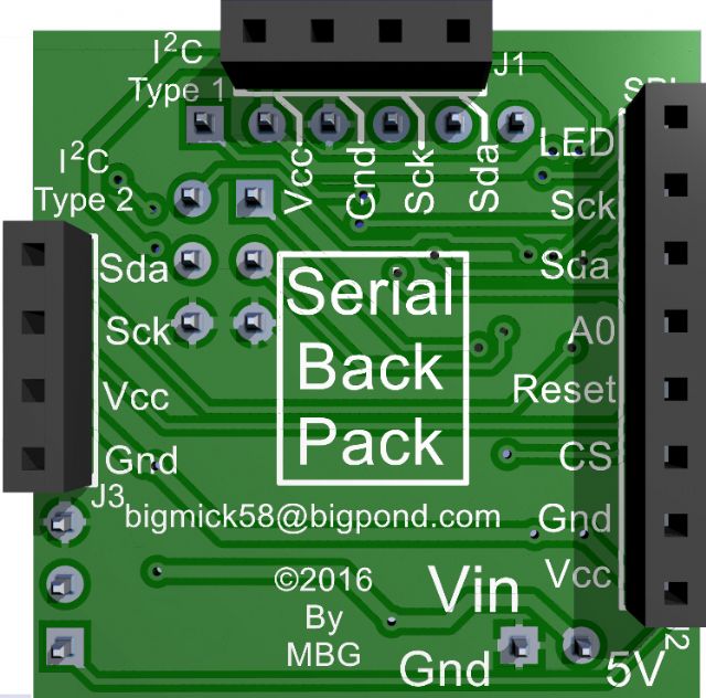

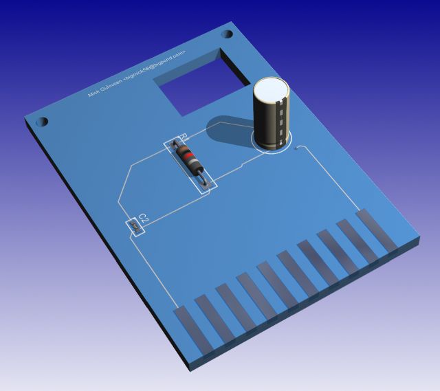

Here are a couple of 3D snap shots of the same board.
Anyway this offer is only on until April 30th so get in whilst the offer is there..

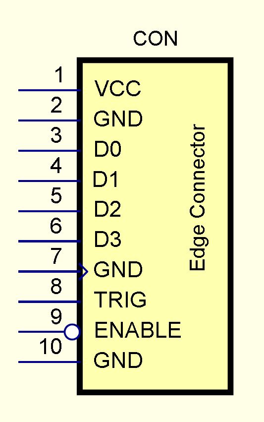

  Geoffg said   Three questions:
- In the schematic editor does it insist on using European symbols or can it use US symbols like zig zag resistors.
- Does it come with a library of footprint and outlines? Is it an extensive library? Are there libraries on the net that can be used?
- Is the autorouter any good?

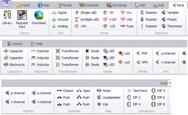

1. You can chose from a wide variety of symbols.
This screen shot shows the `Parts Ribbon' that I cut in 3 to fit the TBS screen. You will note the standard resistors with the zigzag is in there, When you add it you can then select the size, type and value etc of the part that you add to the schematic.

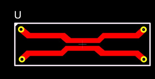

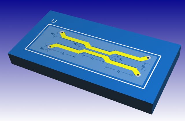

Things like these:
The dimensions of these shapes can be complicated.
I suspect that instead of using interconnect lines, a new component "Pad" could be made with all the cuts, angles, and dimensions.
Anyway, I do need a new circuit layout program. My old "Electronica Workbench v5.6", while useful, is clunky and hard to use.

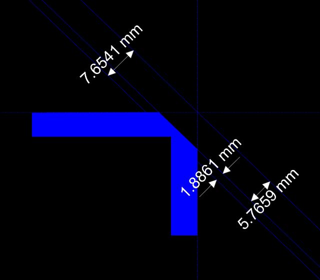

Hi Redrok,
Iliya, the author, has sent me these answers for you..
From Iliya:
Part answer to topic on your forum.
DEX works in floating point numbers.
You can enter exact numbers.
Use graphics for exact shapes – these will be exact in Gerber files with sharp corners etc.
Construction
See attached projects.
This is a usable part – see attached project.
1. Copy and paste image from site, made it semi-transparent and locked it.
2. Turned snaps off.
3. Added horizontal and angled guides.
4. Turned snap to guides on.
5. Added 1 polygon at the top using guides to snap corners.
6. Copied and pasted polygon.
7. Rotated copy 180 degrees by pressing space bar twice.
8. Moved copy into position.
9. Delete guides.
10. Unlock and delete image.
11. Added 4 pads.
12. Rebuilt symbol and tidy up.
13. Save and use!
Iliya Kovac
2016-04-25_220650_project.zip
Mick Back Again:
Iliya, Obviously understood what you needed (I am still a bit in the dark) anyway the Zip has the parts that he has created as well as the Part for the Chamfered Angle.
Hopefully that answers your question.
I also must say that Iliya has always been there and prompt with his help when people are stuck. He does offer a part creation service, however I do not know if there is a fee for that, best to email him if/when you require that service.
Kind Regards,

Redrock is creating tuned circuits which consist of exact sized sections of copper and not much else.
Very useful for high frequency amplifiers and oscillators etc.
Being able to do that in DEX will make life a lot easier.

@ RedRok,
The images lost a fair bit of detail when I added them (the first image shows your guidelines added but are almost impossible to see in the TBS reduced image format.. so I have added all of the images to these ZIP files for you. 2 ZIPS to keep under the 500kB size limits of TBS.
2016-04-25_234805_Images.zip
