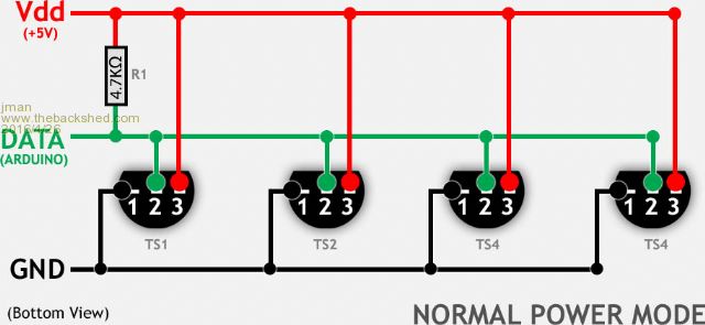

Do you have the sensors connected like the pic below?
What value is your pullup resistor? and is to 5V
Jman

Hi,
That's basically how I have them connected. the pullup is right at the MicroMite, between +5 & the I/O pin I am using, and it's 4.7k. They are all powered off the 5 Volt rail.
Happy to post feedback from the 6 sensors I currently have. I have another dozen or so on the way.

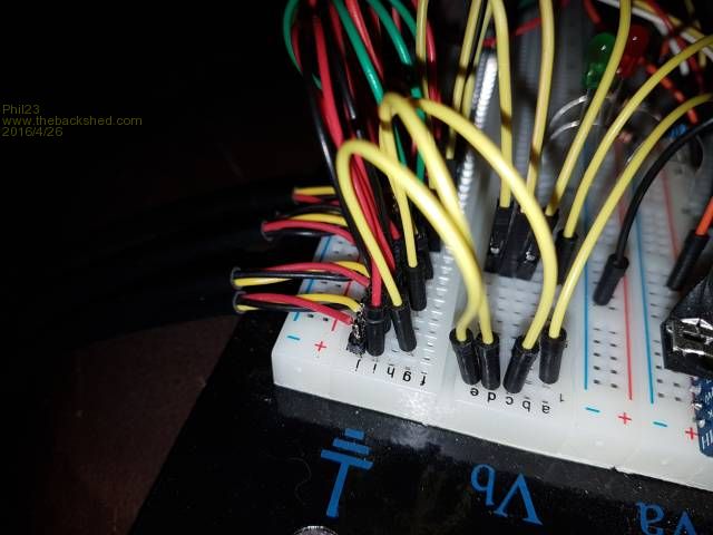

Phil23
Joined: 27/03/2016
Posts: 1667
Posted: 10:58pm 25 Jun 2016
  TassyJim said   I would be looking at length of cables, value of pullup resistor and connections.
Hi Jim & others,
Just thinking further to you comment.
In the picture I posted above, sensors connected to the bread board;
5 have 3m cables, the 6th one is only 1m.
Initially I had 3 connected;
the routine ran & terminated normally.
I added 3 more & it got stuck in the loop.
At the time I removed the first 3 & tried it again on the remaining 3 sensors, and got the same result, it got stuck in the loop.
Tried the original 3 again & all fine, added a 4th & stuck in the loop again.
Tried a couple of different combinations of 3 & they didn't work as expected.
Just suspect that the logic is not fully progressing for given bit map patterns in the serial numbers.
The tutorial I read said 63 passes were needed for each bit search, but I think it drops out before completing graciously.
The logic of how to search a bus only half makes sense to me, but don't quire get how it relates to the BASIC code.
Have tried looking at Arduino example that are supposed to work, but get lost in the code variation & their dependencies on libraries, but it seems pretty accepted in their world that search routines can be easily written.
