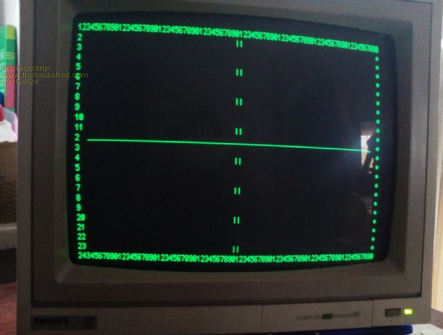

Hi. I have assembled the ASCII Video Terminal PCB with 270F256B preprogrammed from Silicon Chip. Works fine. Now I bought a 250F128B, programmed Terminal_V1.3_plus_Bootloader.hex in it with PICKIT3. Works fine. Last step. I installed MPLAB X IDE 3.25, I can build the sources which Geoff published. I had to solve mising plib, but it seems ok now. In dist/default/production directory there is file Terminal.production.hex. If I program this in 250F128B it will not work.
Also there are three different versions of hex. One with bootloader bundled (368kB), another from Geoff's sources download in directory dist/default/production (155kB). If I build sources I get Terminal.production.hex (189kB).
I have been using Netbeans ever since 2001 or so, but I am new to PIC. That makes MPLAB X IDE perfect fit for me. What I would like to do, is to modify the firmware for composite green phosphor CGA monitor, capable of displaying 80 chars per line. At least I will learn something about PIC32 along the way. Can please someone shed some light on build process and different hex sizes?

You must use the bootloader to load the HEX file if you build your own version from the source. If you used a PICKit3 you will have overwritten the bootloader and that is why it will not start.
The full version incl bootloader is in the Construction Pack.

Thanks Geoffg. I tried it with bootloader and it works. So far I have only hacked menu a little. Will start with video generation as a next step. Sorry if it is stupid question but why must I use bootloader? It almost seems I bought PicKit3 for no purpose.

It actually already works. Strange, it was too easy. I am sure some timings are out of specs. But I can now have "almost authentic feeling" CP/M machine with real green phosphor 24 rows x 80 columns VT100 compatible terminal and two 5.25 inch drives (btw). Monitor used is Philips BM7502.
