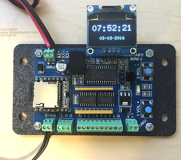

Hey Grogster, I have had good luck with THESE . I use them with the uMite on one of my little boards... $.065 at qty. 100, not bad.
You can see two of them on this board and they take up very little space. I use sip pullups on the output and sip current limit on the input because they are very skinny and take up little space.

@ viscomjim - cute wee board you have there. What is it? I see it seems to be using one of those MP3 player modules among other things.....

Hi Grogster, the board is just a simple sound unit with 8 inputs and 1 2A mosfet output that is turned on when the sound is active. One of my friends uses it in his "agritourism" business. He uses it in several different games and such. One also found its way into a pinball machine refurb. Kinda of just a general purpose sound board.
I see where you mentioned some long cable runs. I just came across this problem with one of his games. He is using unshielded telephone cable in very long runs and the unit would trigger "wierdly". I'm talking 500' runs here which was not discussed prior to this design. So to get things rolling, I simply added 8 .1uf caps from the screw terminals (inputs) to ground and the unit was rock solid. Triggered perfectly every time. He was using "shock" sensor switches that has an amazing amount of bounce. With the caps, all worked perfectly. Using short runs, ie 50' or less, no caps were needed and debounce was done in software.
The board also has the TSOP4838 on board and I2C broken out for expansion (more inputs or outputs) or RTC or OLED as shown in the pic. The 2A mosfet can be used to power 12v stuff like a relay or led strip. It also has a little DC DC converter so it can be powered from 6 to 24 volts without any heat issues.Edited by viscomjim 2016-04-17
