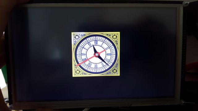

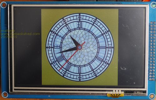

The clever bit is a new CFunction that reads one or more triangular shapes off the display into a buffer and then can write one or more single colour triangles back onto the display.
Why triangles? Because they are the easy way to display a rectangle rotated by other than multiples of 90 degrees. A rectangle can be considered as two triangles by splitting it along one of the diagonals. Using simple trigonometry we can rotate the points making up the triangle about an arbitrary point and then we can then use the "fill triangle" routine to display it on the screen.
The clock program uses two triangles for the second hand and one each for the minute and hour hands. Of course, the technique is infinitely expandable to any number of triangles and not limited to "clocks".
The key calls in the program are:
if first then
i=triangles(nt, buff() , tcol(nt), xx0(nt), yy0(nt), xx1(nt), yy1(nt), xx2(nt), yy2(nt))
print "Read buffer is ",i/buffersize*100,"% used"
first=0
else
i=triangles(nt*2, buff() , tcol(), xx0(), yy0(), xx1(), yy1(), xx2(), yy2())
endif
The first time into the code the CFunction is called to read in the background where the first triangles are to be written and write out the required number of triangles (nt). The background is read into the array "buff". It does this when the colour for the triangle is specified.
Subsequently, the same call is used but with twice the number of triangles. In this case the first set have the colour set to -1. This tells the CFunction to write out the triangles using whatever is stored in "buff" and you will see in the rest of the program the coordinates of the first set of triangles are those previously displayed. This restores the background to its original status. The the new triangles are then drawn but as before their background is read and stored before they are displayed.
As the CFunction does all the difficult work the complete program is pretty simple.

option explicit
option default none
const buffersize = 2500
dim integer buff(buffersize)
dim integer nt=4 'Number of triangles being updated
dim integer xx0(nt*2-1),yy0(nt*2-1),xx1(nt*2-1),yy1(nt*2-1),xx2(nt*2-1),yy2(nt*2-1),tcol(nt*2-1),secs,mins,hours,first=1
cls
load image "bigben.bmp",160,0
Circle MM.Hres\2, MM.Vres\2, (MM.Vres\2-MM.Vres\12)\12, 0, , rgb(red), rgb(red))
Circle MM.Hres\2, MM.Vres\2, (MM.Vres\2-MM.Vres\12)\15, 0, , 0, 0
Circle MM.Hres\2, MM.Vres\2, (MM.Vres\2-MM.Vres\12)\20, 0, , RGB(gray), RGB(gray)
secs=val(right$(time$,2))
mins=val(mid$(time$,4,2))
hours=val(left$(time$,2))
do
hands(secs,mins,hours,(MM.Vres\2-MM.Vres\12),MM.Hres\2, MM.Vres\2)
secs = (secs + 1) mod 60
if secs=0 then mins = (mins+1) mod 60
if hours=0 then hours = (hours+1) mod 12
pause 1000
loop
end
Sub hands(seconds As integer, minutes as integer, hours as integer, size as integer, x as integer, y as integer)
Local integer x1,y1,x2,y2,x0,y0,i
local float angle=seconds*6
rotatetriangle(2,RGB(RED),angle,x,y,-3,50,3,50,-3,-size) 'make up the second hand with two triangles
rotatetriangle(3,RGB(RED),angle,x,y,3,-size,3,50,-3,-size)
angle=minutes*6 + seconds/10
rotatetriangle(0,RGB(BLACK),angle,x,y,-size/15,0,size/15,0,0,-size*0.8)
angle=hours*30 + minutes/2
rotatetriangle(1,RGB(BLACK),angle,x,y,-size/12,0,size/12,0,0,-size*0.5)
if first then
first=0
else
endif
Circle x,y, size\12, 0, , rgb(red), rgb(red))
Circle x,y, size\15, 0, , 0, 0
Circle x,y, size\20, 0, , RGB(gray), RGB(gray)
End Sub
sub rotatetriangle(n as integer, col as integer, angle as float, x as integer, y as integer, x0 as integer, y0 as integer, x1 as integer, y1 as integer, x2 as integer, y2 as integer)
local float sine=sin(rad(angle)),cosine=cos(rad(angle))
local integer x0a,y0a,x1a,y1a,x2a,y2a
x0a= x0*cosine - y0 * sine + x
y0a= y0*cosine + x0 * sine + y
x1a= x1*cosine - y1 * sine + x
y1a= y1*cosine + x1 * sine + y
x2a= x2*cosine - y2 * sine + x
y2a= y2*cosine + x2 * sine + y
xx0(n)=xx0(n+nt)
yy0(n)=yy0(n+nt)
xx1(n)=xx1(n+nt)
yy1(n)=yy1(n+nt)
xx2(n)=xx2(n+nt)
yy2(n)=yy2(n+nt)
xx0(n+nt)=x0a
yy0(n+nt)=y0a
xx1(n+nt)=x1a
yy1(n+nt)=y1a
xx2(n+nt)=x2a
yy2(n+nt)=y2a
tcol(n)=-1
tcol(n+nt)=col
end sub

PS on the Big Ben glass can I read cafe?
GM
Posts: 10109
Posted: 12:39am 10 Apr 2016
Nice one!
@ OA47 - Yes, you can. I can see it too, and there is another word under that, but I can't make it out.
Posts: 12185
Posted: 12:44am 10 Apr 2016
  Quote  PS on the Big Ben glass can I read cafe?
Some sort of watermark on the image lew247 sent me. Seems to say "cafe press"

lew247
Joined: 23/12/2015
Posts: 1709
Posted: 05:58am 10 Apr 2016
Attached, Royalty Free picture (very similar to the above)
Definitely no watermarks, I bought the picture to get it royalty free - so feel free to use it.
Size 480 X 480 so it will fit in the program perfectly.
Unfortunately I cannot upload the zip file of the correct .bmp file as it's too large.
Right click on the picture and you should be able to download it.
Edit: for some reason when you download it, it's coming up as a .png file - but you can convert it to .bmp using any program or send me a message with your email address if you want me to send you the original which is a lot larger (or this size in bmp format)
Edited by lew247 2016-04-11

2016-06-17_204306_bigben.zip Matherp - or anyone else
Could somone be so kind as to tell me the mods to get the hands of the clock showing in the correct position and size please?
I have resized the clock face so it's 240X240 pixels and have it positioned on the left hand side of the screen in the centre of the display
I have it showing correctly where i want it with the following section of code
[code]load image "bigben.bmp",0,120 [/code]
However I cannot work out how to get the actual clock hands in the correct position.
[code]
[/code]
I believe that is the centre circles of the clock and it gets its position by asking the display what size it is then dividing that size by 2 to get it in the centre (MM.Hres\2, MM.Vres\2)
I THINK that's how it works
[code]hands(secs,mins,hours,(MM.Vres\2-MM.Vres\12),MM.Hres\2, MM.Vres\2)[/code]
I THINK that does the same with the hands
The bit I cannot work out is how to position the hands in the centre of my clock!!!!!
It should be easy to figure out but myt brain is not letting me see the simple answer
it's probably something like
[code]Circle MM.Hres\6, MM.Vres\4, (MM.Vres\6-MM.Vres\12)\12, 0, , rgb(red), rgb(red))
Circle MM.Hres\6, MM.Vres\4, (MM.Vres\6-MM.Vres\12)\15, 0, , 0, 0
Circle MM.Hres\6, MM.Vres\4, (MM.Vres\6-MM.Vres\12)\20, 0, , RGB(gray), RGB(gray)
[/code]
BUT I cannot work it out
Anyone able to help please?
I've included the 240X240 bmp in the zip file
Edited by lew247 2016-06-18
Posted: 10:51am 17 Jun 2016
You know the exact size of the bitmap and you know where you put it on the screen. Work with those values and not use the Hres and VRes variables.
If the bitmap is 240x240 and you placed it at 0,120
then the center will be 0+120, 120 + 120 -> x=120,y=240
Draw a small circle to make sure you are exactly in the center, then work from there.
Edited by MicroBlocks 2016-06-18

lew247
Joined: 23/12/2015
Posts: 1709
Posted: 08:44am 18 Jun 2016
What I need to do somehow is move the centre of the clock to 120,360
and then make the size of all the hands 1/2 the size they are now
Actually thinking about it some more, I could work round the clock being in the centre of the display
However I would still need to work out (or be told ideally) how to make the hands 1/2 the size they are now
Edited by lew247 2016-06-19
Posts: 12185
Posted: 10:03pm 18 Jun 2016
Lewis
This really isn't hard. Look at the definition of the hands subroutine:
x and y are the coordinates where you want the centre of the hands, i.e. in the middle of your clock face. Size is the length of the biggest hand in pixels. I found by experimentation that with the bigben image the size should be 5/6ths of half the image height in your case 5/6*120 = 100. But if this isn't quite right just try something else!
The lines
  Quote  Circle MM.Hres\2, MM.Vres\2, (MM.Vres\2-MM.Vres\12)\12, 0, , rgb(red), rgb(red))
Can probably omitted completely.
In general you need to just try things and see what happens. If you don't understand what
  Quote  (MM.Vres\2-MM.Vres\12)\15
is doing put in a print statement and see what value it is generating and then think about what value you might need for your size of display.
The whole point of interpretive Basic is that you can repeatedly modify/retest code until it does what you want. If in this example the hands end up somewhere incorrect then just make a change and rerun you can't do any harm.
I have all my code on Dropbox. This has the advantage that you can always recover a previous version without having to remember to take backups - very useful.Edited by matherp 2016-06-20
