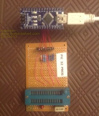

btw, would you mind posting a photo of your programmer (arduino nano setup) online? it is nice to see that folks are using this method of uploading firmware.

Here is a photo of my programmer using the Aduino Nano.
