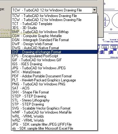

Here below is what my CAD files can be exported as......
I see that there is reasonable cost software on the market that can do conversions, like GerberView etc, but I am not sure it this software will work.?

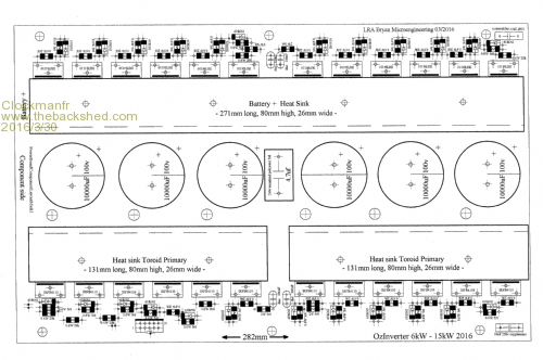

Here is a reduced quality jpg of the board layout.
As you can see, the FET legs are deliberately splayed out. The copper double side boards should be double thickness ie 70 micron. The heat sinks and the caps down the centre are deliberate, as these are forced cooled when the board is pulling serious kW's. The board design is optimum for copper use, and boy do I need plenty of copper around those FET's. Might even need to beef that copper up, but will test first.

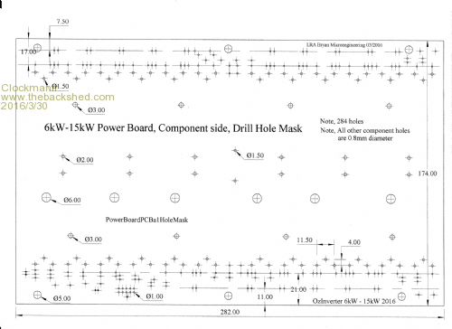

Here is the drill mask with some dimensions.

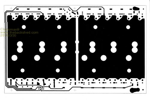

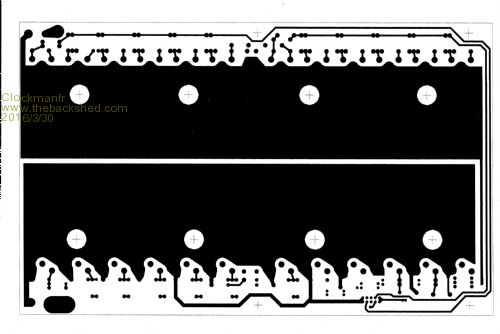

Posted: 09:43am 30 Mar 2016
Just so you can see what your getting involved with....
Top board Mask.....
And under board mask.....this is a Mirror as it fits on the underside from the underside.
EPS files are okay and look reasonable.

The idea is that these boards just fit onto sheets of A4 thermal transparencies. I will do exact copies sizes at high res of each mask, and put them as a pull out in in the Book. "Making a Low cost, simple and robust 6kW, 50HZ Pure Sine Wave, 48vdc to 230vac, INVERTER".
You get a book you get the full size PCB masks. These can then be copied onto thermal transparencies at your local copy shop with a laser printer and then heated onto the PCB for etching, and then other stages. But it now seems folk want their PCB's made..

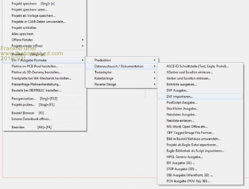

It's relative simple to convert DXF in Gerber:
- create a new job with board only (without circuit)
- import DXF (you have many import functions)
- you can export to Gerber with:
- Files - In-/Output-Formats - Production - (X-)Gerbers
...or press simply F11
- specify your folder and press "Start"
Let me know if I can help you!

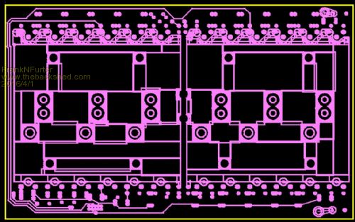

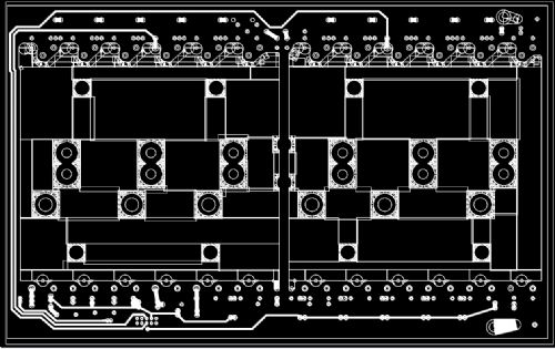

this is your DXF file, imported by Target, exported as Gerber and viewed with GC-Preview:
It seems to be a problem that your tracks are created with many fine lines...
Your problems with the IBF site are strange - you can change your language to French, English or German...
Frank

Yes that's what I get, regards all the fine lines, its CAD entity blocks that define an area where you want a colour change. The way I use it is rough, dirty and quick to keep it a simple drawing without getting the layers mixed up.
However for future reference I can clean those perimeter lines up and just use one line and fill. Not sure about those big holes though.
Target see's all those lines perimeters from the DXF and what's better if you click on them in Target you can manipulate them, I think?.
Grid will need redefining on the TARGET redraw, I normally set it at 0.25mm. So is it possible to redefine the big areas of copper and fill within Target before going to Gerber?
Can we resize the lines to correct size?
Obviously, I wont get this software for a while so hence me asking.
