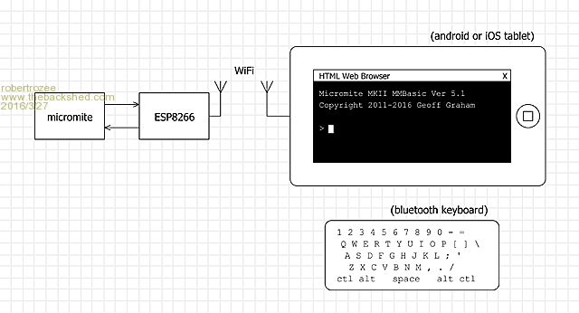

have just been looking around on the web to see if anyone has produced an ESP8266 firmware to use the device as a VT100 terminal. what i have in mind is for the ESP8266 to be attached to a micromite via the serial port, and through the wifi interface present a web page that contains a VT100 terminal window.
one could then use a tablet or PC running firefox or similar, with NO other software needed, and by connecting to the ESP8266 use the micromite's internal editor to write mmbasic code. i'm thinking of this as a way of creating a super-simple wireless setup using an old android tablet + bluetooth keyboard as a terminal, no other software required. as an added bonus, the micromite is electrically isolated from everything.
has anyone found something like this out there. i've had a bit of a dig around, but not found anything this simple - then again, i may not have looked hard enough!
note: this is NOT just passing serial data straight through. the ESP8266 is also providing a VT100 emulation layer, and encapsulating that layer within a single webpage that it serves up. to keep things simple, the ESP8266 would present itself as an isolated wifi hotspot without any internet connectivity.

it is pretty neat, but not quite what i have in mind - the crome plugin essentially turns chrome into a teraterm workalike, with the connection to the target via a wired serial port (according to the demo video).
perhap this diagram better shows what i have in mind:
rob :-)
Posted: 05:52am 27 Mar 2016
That's what I thought you meant but it does seem extraordinarily painful to "want" VT100 between the left 2 items (umite & esp).
Some "fun" will also be needed if you go that route to cope with the browser.
