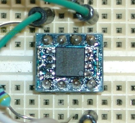

This one I'm pleased with
Since playing with the ESP8266 I've been interested in exploring how Serial Flash memory chips could be used for secure data logging on the Micromite as an alternative to SDcards or an external device like an Openlog.
These chips are ridiculously cheap so there is no reason not to include one on every PCB. Winbond branded chips work perfectly with the program and are recommended.
The example shown above is the one I used to develop the code and will hold 4Mbytes. Compatible chips are available from 512kbyte to 16Mbytes and the code should automatically cater for any of them.
Connections to the 8-pin chips are simple:
pin 1 (chip select) - connect to any Micromite output capable pin
pin 2 (Data out) - connect to the SPI-IN pin on the Micromite
pin 3 (write protect) - 10K resistor to 3.3V
pin 4 (GND) - connect to ground
pin 5 (Data in) - connect to the SPI-OUT pin on the Micromite
pin 6 (Clock) - connect to the SPI-CLK pin on the Micromite
pin 7 (Hold) - 10K resistor to 3.3V
pin 8 (VCC) - connect to 3.3V
The chips are a wide version of SOIC and can be easily soldered to a DIP adapter. This could then be socketed on the PCB allowing it to be swapped for reading separately in the same way as an SD card.
The intention of the coding was to hide all the workings of the chip from the user and make the user interface as simple as possible so there are just three user routines:
formatlog(chip_select_pin_number)
This routine completely erases the chip and tests it for correct erasure. In the event that the erase fails the routine will print a message and the program will end. The routine prints the ID of the chip and the size in Mbytes. It also writes to the chip an index of used pages that the logging routine uses to determine where a new record should be appended.
writelog(string-to-write, chip_select_pin_number, timestamp)
This routine appends the supplied string to the log. If the variable "timestamp" is non-zero it will automatically prepend the date and time comma-separated to the front of the string. If timestamp is 0 or not specified the string will be written as supplied. Logging strings can be constructed in the normal way using STR$ to format numbers and the "+" operator to concatenate multiple sub-strings.
readlog(chip_select_pin_number)
This routine reads the complete log and prints the contents to the console. To upload to a PC just set Teraterm (or equivalent) to record the terminal session and call readlog. The routine does not change the log data in any way so logging can be restarted after reading without any impact.
NB all of the routines are completely self-contained and can be called from the command line with no requirement for anything to have been run or set up previously - there are no global variables or constants - everything required to run is stored on the chip itself. They also obey the requirements for sharing the SPI bus with a TFT screen on the Micromite.
This means calls to the formatlog and readlog routines need never be included in the running program as they can just be called from the command line as and when required.
It really can't get any easier to include logging in any Micromite program.
The test program attached demonstrates just how easy it is to including logging commands in a program. I've tested the code using 1000, 10000, and 100000 log records. It takes 183 seconds to construct and log 10000 records.
The C-source is attached, there is nothing complicated and it was all written first in Basic and then just converted to C for improved performance.

an excellent concept that looks extremely useful. i would love to see something similar included within the next micromite 2 firmware release.
might i suggest one more function:
a$ = readlogline(CS, i)
this would be used thus:
i = 0
do
if (i>0) print a$
loop until (i=0)
calling with i=0 would initialize to the start of the flash chip. the variable i would return containing addressing information for the next line to read (could be page number and offset into page), or 0 if there is no next line to read.
with this addition, a flash chip could be used to hold data that an mmbasic program could itself make use of.
rob :-)Edited by robert.rozee 2016-03-28

Posts: 11894
Posted: 03:20am 27 Mar 2016
  Quote  with this addition, a flash chip could be used to hold data that an mmbasic program could itself make use of.
Rob you already have everything needed to do something like this in the current code:
the function "writepage" writes a block of data to a specific page on the chip
writepage(page_number, data, chip_select_pin)
because of the way variable passing to CFunctions works "data" can be anything that adds up to 256 bytes
dim string mystring$ length 255 '1 byte length + 255 bytes of data
dim float myfloats!(63) ' 64 x 4-bytes
DIM integer myintegers%(31) '32 x 8-bytes
Likewise "readpage" can do the same thing
readpage(page_number, mystring$, chip_select_pin)
readpage(page_number, myfloat!(), chip_select_pin)
readpage(page_number, myintegers%(), chip_select_pin)
I specifically wanted to make the logging commands context free i.e. the Basic program shouldn't have to remember anything in order to use them. However, using the primitives as above you can use the flash chip for anything. If you want to use logging in addition then it is probably best to do direct access to high pages in the flash memory and then logging will continue to work from the beginning of flash. It would then be up to the Basic program to know what was in each page used in this way. Effectively readpage and writepage allow direct access to any 256-byte record. The log data can't be treated in this way as it is effectively a sequential stream so to access the 100th string you have to read the first 99 first.
readpage and writepage would just need wrapping with SPI OPEN and SPI CLOSE commands and if used by themselves the user would need to ensure chip_select_pin was set as an ouput (this is done at the moment in C by the "pagecount" comand)
Posts: 11894
Posted: 03:25am 27 Mar 2016
Do Serial Flash Memories not have page boundaries to worry about like EEPROM?
Yes pages for writing are on 256-byte boundaries. My code takes care of all this for you without wasting any space.
The 4K "page" is the minimum that can be erased but I only use full chip erase.
Flash memory is erased to all "1s". Writes convert the relevant 1s to 0s. So I can write the same data to a page with no effect or I can write additional data to a page that is part written by reading what was there, updating with the new data and then re-writing.

Posts: 11894
Posted: 06:36am 27 Mar 2016
UPDATE
I should have mentioned in the original post that the spare pad on the back of many TFT displays will take one of the 25Q series chips and, at least on the displays I've checked, is correctly wired. The only additional connection is to the F_CS chip select pin on the display.
To improve logging speed by a factor of 2 please substitute this CFunction

Shall be used:
CONST ULBPL=& H98 'GLOBAL UNLOCK PROTECTION BLOCK
SNDCMD (ULBPL)
before format and write.
ULBPL SOORCE: http://electronics.stackexchange.com/questions/156429/cant-seem-to-write-to-spi-flash
The amendment which was sent, the result:
> RUN
JEDEC ID = BF2642
Memory size is 32 Mbits
Format complete
1,000 records constructed and logged in 9 seconds
Reading is nothing (due to lack ULBPL-by my opinion)
Best regards
drkl
Posts: 11894
Posted: 06:10am 29 Mar 2016
Why do Microchip have to make things so difficult
Please try this version and let me know if it works.
NB for anyone using Winbond chips, stick with the original SMALLER version

Posted: 08:05am 29 Mar 2016
Hello Peter,
It operates!!!
Many, many thanks for you.
You are an always helpful, (and very clever) man.
drkl
