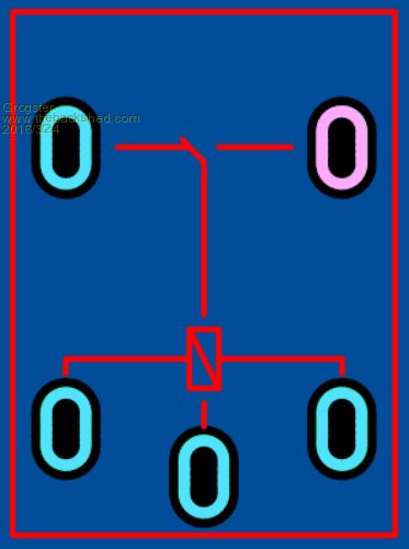

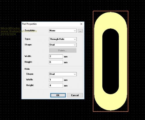

Posted: 01:17am 24 Mar 2016
That is why i choose diptrace.
It is simple and done in about 10 seconds
So far i can create any component and footprint that i want.
Copper can be square, round, oval and polygon.
A hole in the pad is limited to round or oval. That limit is probably also when manufacturing so it might not be a real limit.
If there is one thing i really hate, it is wasting time trying to do something simple. I tried a few schematic/pcb software before deciding on diptrace. I tested with a through hole USB connector with yes oval pads. That was the end for Eagle, could not be done.
