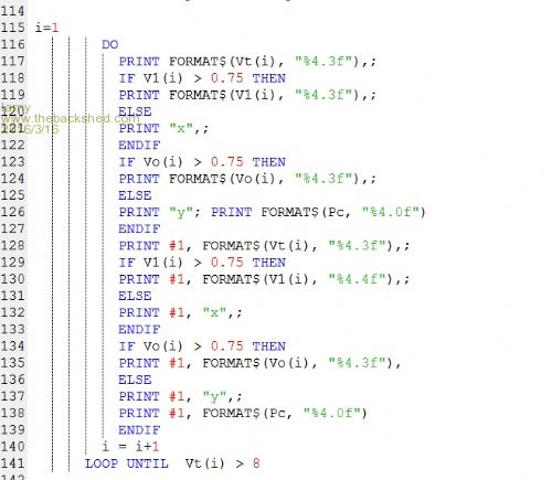

larny
Joined: 31/10/2011
Posts: 349
Posted: 10:57pm 15 Mar 2016
Thanks for the replies. I had an idea after posting this thread. I solved the issue by inserting a line feed at line 120 & I may ( I don't now remember) have added a : as someone suggested.
However, I can see that it is better to insert one statement per line, so I'll adopt that method from now on.
I'm not using Line Numbers. The numbers were inserted by MM Edit.
I'm glad to see the last of them.
Here is a view of the modified code which shows the line numbers.
