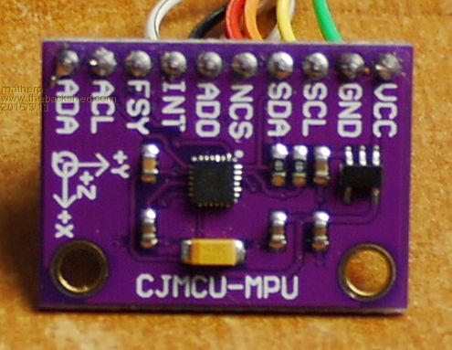

The MPU-9250 is a 9-DOF Motion tracking device comprising 3-axis accelerometer, 3-axis gyro and 3-axis magnetometer.
It is comparatively cheap given the functionality provided.
It provides all the input required to monitor and maintain the position of an object in 3-dimensional space and is typically used in the the attitude reference system (AHRS) in things like drones.
The attached code provides all the functionality required to calibrate and operate the device as well as providing a sensor fusion engine to integrate the 9 readings into a single representation of the orientation of the sensor.
The MPU-9250 actually contains 2 separate devices on the chip's die. The MPU-9250 itself does the acceleration and gyro measuremnts and there is also an integrated AK8963 magnetometer.
To use the device the module must first be calibrated and the calibration parameters noted and included in the code

' Push gyro biases to hardware registers
writeByte(MPU9250_ADDRESS, XG_OFFSET_H, rData(0))
writeByte(MPU9250_ADDRESS, XG_OFFSET_L, rData(1))
writeByte(MPU9250_ADDRESS, YG_OFFSET_H, rData(2))
writeByte(MPU9250_ADDRESS, YG_OFFSET_L, rData(3))
writeByte(MPU9250_ADDRESS, ZG_OFFSET_H, rData(4))
writeByte(MPU9250_ADDRESS, ZG_OFFSET_L, rData(5))
readBytes(MPU9250_ADDRESS, XA_OFFSET_H, 2, rData()) ' Read factory accelerometer trim values
accel_bias_reg(0) = iint15((rData(0) << 7) OR ((rData(1) and &HFE)>>1))
if rData(1) and &H1 then mask_bit(0)=&H1
readBytes(MPU9250_ADDRESS, YA_OFFSET_H, 2, rData())
accel_bias_reg(1) = iint15((rData(0) << 7) OR ((rData(1) and &HFE)>>1))
if rData(1) and &H1 then mask_bit(1)=&H1
readBytes(MPU9250_ADDRESS, ZA_OFFSET_H, 2, rData())
accel_bias_reg(2) = iint15((rData(0) << 7) OR ((rData(1) and &HFE)>>1))
if rData(1) and &H1 then mask_bit(2)=&H1
' Construct total accelerometer bias, including calculated average accelerometer bias from above
accel_bias_reg(0) = accel_bias_reg(0) - (accel_bias(0)\16) ' Subtract calculated averaged accelerometer bias scaled to 2048 LSB/g (16 g full scale)
accel_bias_reg(1) = accel_bias_reg(1) - (accel_bias(1)\16)
accel_bias_reg(2) = accel_bias_reg(2) - (accel_bias(2)\16)
rData(0) = (accel_bias_reg(0) \ 128) AND &HFF
rData(1) = ((accel_bias_reg(0))<<1 ) AND &HFE
rData(1) = rData(1) OR mask_bit(0) ' preserve temperature compensation bit when writing back to accelerometer bias registers
rData(2) = (accel_bias_reg(1) \ 128) AND &HFF
rData(3) = ((accel_bias_reg(1)) <<1) AND &HFE
rData(3) = rData(3) OR mask_bit(1) ' preserve temperature compensation bit when writing back to accelerometer bias registers
rData(4) = (accel_bias_reg(2) \ 128) AND &HFF
rData(5) = ((accel_bias_reg(2))<<1) AND &HFE
rData(5) = rData(5) OR mask_bit(2) ' preserve temperature compensation bit when writing back to accelerometer bias registers
' Push accelerometer biases to hardware registers
writeByte(MPU9250_ADDRESS, XA_OFFSET_H, rData(0))
writeByte(MPU9250_ADDRESS, XA_OFFSET_L, rData(1))
writeByte(MPU9250_ADDRESS, YA_OFFSET_H, rData(2))
writeByte(MPU9250_ADDRESS, YA_OFFSET_L, rData(3))
writeByte(MPU9250_ADDRESS, ZA_OFFSET_H, rData(4))
writeByte(MPU9250_ADDRESS, ZA_OFFSET_L, rData(5))
end sub
sub MadgwickQuaternionUpdate(ax as float, ay as float, az as float, gx as float, gy as float, gz as float, mx as float, my as float, mz as float)
LOCAL float q1 = q(0), q2 = q(1), q3 = q(2), q4 = q(3)' short name local variable for readability
LOCAL float norm
LOCAL float hx, hy, _2bx, _2bz
LOCAL float s1, s2, s3, s4
LOCAL float qDot1, qDot2, qDot3, qDot4
' Auxiliary variables to avoid repeated arithmetic
LOCAL float _2q1mx
LOCAL float _2q1my
LOCAL float _2q1mz
LOCAL float _2q2mx
LOCAL float _4bx
LOCAL float _4bz
LOCAL float _2q1 = 2.0 * q1
LOCAL float _2q2 = 2.0 * q2
LOCAL float _2q3 = 2.0 * q3
LOCAL float _2q4 = 2.0 * q4
LOCAL float _2q1q3 = 2.0 * q1 * q3
LOCAL float _2q3q4 = 2.0 * q3 * q4
LOCAL float q1q1 = q1 * q1
LOCAL float q1q2 = q1 * q2
LOCAL float q1q3 = q1 * q3
LOCAL float q1q4 = q1 * q4
LOCAL float q2q2 = q2 * q2
LOCAL float q2q3 = q2 * q3
LOCAL float q2q4 = q2 * q4
LOCAL float q3q3 = q3 * q3
LOCAL float q3q4 = q3 * q4
LOCAL float q4q4 = q4 * q4
' Normalise accelerometer measurement
norm = sqr(ax * ax + ay * ay + az * az)
if (norm = 0.0) then exit sub' handle NaN
norm = 1.0/norm
ax = ax * norm
ay = ay * norm
az = az * norm
' Normalise magnetometer measurement
norm = sqr(mx * mx + my * my + mz * mz)
norm = 1.0/norm
mx = mx * norm
my = my * norm
mz = mz * norm
' Reference direction of Earth's magnetic field
_2q1mx = 2.0 * q1 * mx
_2q1my = 2.0 * q1 * my
_2q1mz = 2.0 * q1 * mz
_2q2mx = 2.0 * q2 * mx
hx = mx * q1q1 - _2q1my * q4 + _2q1mz * q3 + mx * q2q2 + _2q2 * my * q3 + _2q2 * mz * q4 - mx * q3q3 - mx * q4q4
hy = _2q1mx * q4 + my * q1q1 - _2q1mz * q2 + _2q2mx * q3 - my * q2q2 + my * q3q3 + _2q3 * mz * q4 - my * q4q4
_2bx = sqr(hx * hx + hy * hy)
_2bz = -_2q1mx * q3 + _2q1my * q2 + mz * q1q1 + _2q2mx * q4 - mz * q2q2 + _2q3 * my * q4 - mz * q3q3 + mz * q4q4
_4bx = 2.0 * _2bx
_4bz = 2.0 * _2bz
' Gradient decent algorithm corrective step
s1 = -_2q3 * (2.0 * q2q4 - _2q1q3 - ax) + _2q2 * (2.0 * q1q2 + _2q3q4 - ay)
s1 = s1 - _2bz * q3 * (_2bx * (0.5 - q3q3 - q4q4) + _2bz * (q2q4 - q1q3) - mx)
s1 = s1 + (-_2bx * q4 + _2bz * q2) * (_2bx * (q2q3 - q1q4) + _2bz * (q1q2 + q3q4) - my)
s1 = s1 + _2bx * q3 * (_2bx * (q1q3 + q2q4) + _2bz * (0.5 - q2q2 - q3q3) - mz)
s2 = _2q4 * (2.0 * q2q4 - _2q1q3 - ax) + _2q1 * (2.0 * q1q2 + _2q3q4 - ay)
s2 = s2 - 4.0 * q2 * (1.0 - 2.0 * q2q2 - 2.0 * q3q3 - az) + _2bz * q4 * (_2bx * (0.5 - q3q3 - q4q4)+ _2bz * (q2q4 - q1q3) - mx)
s2 = s2 + (_2bx * q3 + _2bz * q1) * (_2bx * (q2q3 - q1q4) + _2bz * (q1q2 + q3q4) - my)
s2 = s2 + (_2bx * q4 - _4bz * q2) * (_2bx * (q1q3 + q2q4) + _2bz * (0.5 - q2q2 - q3q3) - mz)
s3 = -_2q1 * (2.0 * q2q4 - _2q1q3 - ax) + _2q4 * (2.0 * q1q2 + _2q3q4 - ay)
s3 = s3 - 4.0 * q3 * (1.0 - 2.0 * q2q2 - 2.0 * q3q3 - az)
s3 = s3 + (-_4bx * q3 - _2bz * q1) * (_2bx * (0.5 - q3q3 - q4q4) + _2bz * (q2q4 - q1q3) - mx)
s3 = s3 + (_2bx * q2 + _2bz * q4) * (_2bx * (q2q3 - q1q4) + _2bz * (q1q2 + q3q4) - my)
s3 = s3 + (_2bx * q1 - _4bz * q3) * (_2bx * (q1q3 + q2q4) + _2bz * (0.5 - q2q2 - q3q3) - mz)
s4 = _2q2 * (2.0 * q2q4 - _2q1q3 - ax) + _2q3 * (2.0 * q1q2 + _2q3q4 - ay)
s4 = s4 + (-_4bx * q4 + _2bz * q2) * (_2bx * (0.5 - q3q3 - q4q4) + _2bz * (q2q4 - q1q3) - mx)
s4 = s4 + (-_2bx * q1 + _2bz * q3) * (_2bx * (q2q3 - q1q4) + _2bz * (q1q2 + q3q4) - my)
s4 = s4 + _2bx * q2 * (_2bx * (q1q3 + q2q4) + _2bz * (0.5 - q2q2 - q3q3) - mz)
norm = sqr(s1 * s1 + s2 * s2 + s3 * s3 + s4 * s4) ' normalise step magnitude
norm = 1.0/norm
s1 = s1 * norm
s2 = s2 * norm
s3 = s3 * norm
s4 = s4 * norm
' Compute rate of change of quaternion
qDot1 = 0.5 * (-q2 * gx - q3 * gy - q4 * gz) - beta * s1
qDot2 = 0.5 * (q1 * gx + q3 * gz - q4 * gy) - beta * s2
qDot3 = 0.5 * (q1 * gy - q2 * gz + q4 * gx) - beta * s3
qDot4 = 0.5 * (q1 * gz + q2 * gy - q3 * gx) - beta * s4
' Integrate to yield quaternion
q1 = q1 + qDot1 * deltat
q2 = q2 + qDot2 * deltat
q3 = q3 + qDot3 * deltat
q4 = q4 + qDot4 * deltat
norm = sqr(q1 * q1 + q2 * q2 + q3 * q3 + q4 * q4) ' normalise quaternion
norm = 1.0/norm
q(0) = q1 * norm
q(1) = q2 * norm
q(2) = q3 * norm
q(3) = q4 * norm
end sub
FUNCTION atan2(y as float,x as float) as float
IF x > 0 THEN
atan2 = ATN(y/x)
ELSEIF y >= 0 AND x < 0 THEN
atan2 = PI + ATN(y/x)
ELSEIF y < 0 AND x < 0 THEN
atan2 = ATN(y/x) - PI
ELSEIF y > 0 AND x = 0 THEN
atan2 = PI / 2
ELSEIF y < 0 AND x = 0 THEN
atan2 = PI / -2
ENDIF
IF atan2 < 0 THEN
atan2 = atan2 + 2 * PI
ENDIF
END FUNCTION
function asin(x!) as float
asin=atn(x!/sqr(1-x!*x!))
end function
Edited by matherp 2016-03-14
