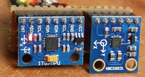

This has taken more effort than any code recently and yet it is all in Basic
However, finally I think it is working well. What is really interesting is how big the variance is in the uncompensated headings with just very small tilts of the magnetometer.
The code uses the MPU6050 and HMC5883 modules which must be orientated relative to each other like this.
The maths is done using quaternions to implement what is termed "sensor fusion". This integrates the output of the accelerometer, the gyro, and the magnetometer to produced a composite quaternion that represents the orientation of the sensors in 3D space. Then using some simple maths this can be translated into normal concepts like roll, pitch and heading (yaw).
Much of the code has been copied and ported from C based on work by Kris Winer which was in turn derived from the original math by Madgwick and Mahoney.
The code also uses some of the Basic routines previously posted by TassyJim.
Before using the code it is essential to calibrate the HMC5883 using this code.
When you run the code you will see the compensated heading slowly slew to the correct value as the fusion engine integrates the magnetic input with the arbitrary start position. This takes 10-15 seconds on a MX470 and somewhat more on a MX170.
Once correct the compensated heading will stay stable even when the sensors are tilted whereas the simple "atan2(y,x)" 2D heading will move significantly.
The code actually implements a complete AHRS system and includes the math for generating pitch and roll as well as heading.

Just to make sure we are seeing the same thing,
My sensors are mounted together the same way as yours but...
Using your image of the two sensors, which way is forward and is the photo taken from above?
I have the X arrow on the HMC5883 pointing forwards and the Y arrow pointing to the left.
Next questions.
Does positive pitch has you climbing?
Is positive roll right wing down?
Posts: 12184
Posted: 10:29pm 11 Mar 2016
The heading will be 0 when X on the HMC5883 points north. Because the MPU6050 and HMC5883 are at 90 degrees to each other this means pitch and roll are reversed just swap them to be consistent and change signs, add/subtract 180 degrees etc. to make them scale as you want.
You will also note that the calculation returns the yaw angle (where is north from me) rather than the heading so I use this calculation
((450-yaw)- declination) mod 360
to convert from the yaw angle to a heading and also to take into account the 90 degree orientation difference and local magnetic declination to give a true heading
Interestingly, the MPU9250 which contains a 9-axis sensor also has the magnetometer at 90-degrees - I've no idea why.
