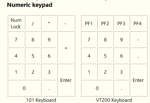

Configuring TeraTerm NumPad for MMBasic
Teraterm can be configured handle the keys on the NumberPad in two ways. If configured as VT220 shown below then the NUMLOCK,"/","*" and "-" send escape codes that are interpreted by MMBasic as the F1-F4 keys as
reported here
  mozzie said
The "NUMLOCK" key works as "ESCAPE" (Actually its F1)
The keypad "/" key works as "F2" / RUN
The keypad "*" key works as "F3" / LIST
The keypad "-" key works as "F4" / EDIT
File KEYBOARD.CNF contains the keyboard mappings.
Teraterm 5 appears to set the NumberPad correctly and NUMLOCK,"/","*" and "-" work as expected.
Teraterm 4 at installation will copy EDITOR.CNF to KEYBOARD.CNF
This sets the function keys (F1-F12) correctly but sets the NumberPad incorrectly.
The file FUNCTION.CNF has the correct settings for the NumerPad. Copy the section below to replace those in the KEYBOARD.CNF file.
