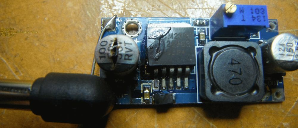

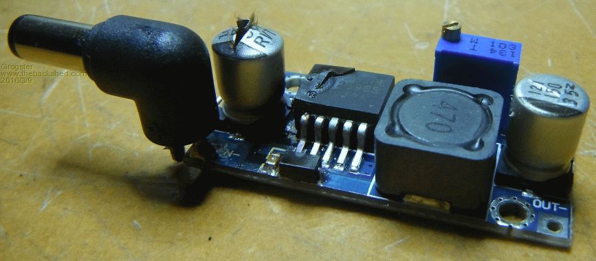

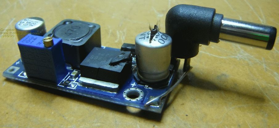

I put the supply rail onto the module in reverse polarity to what it should have been. A very silly schoolboy mistake on my part.
This was an impressive failure. The electro on the input turned into a firework, and the regulator glowed deep orange through the crack in it's case. A surprising amount of smoke came from the electro.
I instantly knew something was very badly wrong at the first 'Crack!' noise, but by the time I had pulled the power, it was all over.....
36v @ up to 11A rail, so cooking this module was nothing to the PSU.
Initial testing following removal of the cooked module reveals no damage, which is lucky. The module was not connected to anything, only the input voltage. Other devices on the same supply don't appear to have suffered for this current surge - lucky me.
Oh well - onwards and upwards.......
EDIT: Just found that the relay that controls the main supply rail is now welded closed.
Therefore, a little bit of damage, so I will have to extract that power relay and replace it. I hate to think the current that could have been flowing into that fault, but I expect it could have been the current limit of the PSU(11A or so), and that has obviously cooked the relay N.O. contacts! Edited by Grogster 2016-03-10

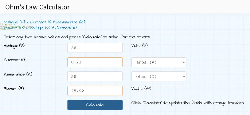

I plan to use a 50R 50W high-power resistor for the series in-rush current limit, which is then bypassed by a relay after a couple of seconds at power-up.
50W resistors
According to Ohm's law, and assuming that the input filter caps on the amp board are effectively equivalent to a short-circuit to ground at the instant you apply power, with them rapidly charging up to rail voltage and the corresponding charge current dropping off at that happens, I calculate the resistor to be dissipating up to 25W @ 36v input with an initial charge current of about 720mA, so I chose 50W resistors.
This appears to all add up in the maths, but in case I am missing something else obvious, I post this here, and anyone who thinks this is a BAD idea, or won't do what I think it will, please do post here so I can rethink the process - but I think this all sounds fine.
It is important to remember that the 50W resistor is only going to be running at about 50% of it's dissipation figure, and it is only in circuit for the initial switch-on surge, after which, it is bypassed by some relay contacts.
You can get 25W resistors - perhaps they would be a better choice due to the fact that this is not a continuous power kind of situation.
I chose the 50W ones for reasons of over-engineering to some extent, as that means they are not being pushed to the maximum if you see what I am getting at.Edited by Grogster 2016-03-11
