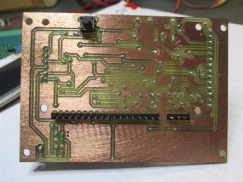

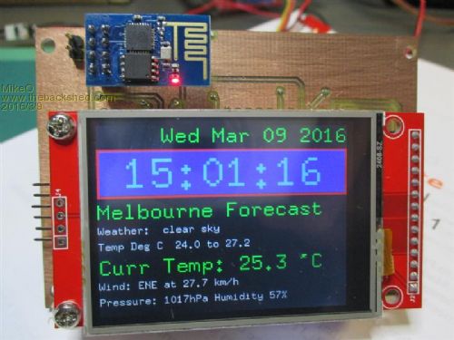

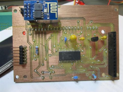

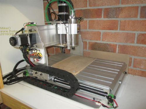

Well yes but with a few differences. Its an adaptation of Geoff's excellent backpack uMite 170 but with a couple of differences, it has a ESP8266 on board it uses a SOIC version of the MCU but lastly the board was cut by CNC! (Useful when you don't want 10 prototypes)
The Clock is synced from the Internet by NCP and it fetches your local weather from OpenWeatherMap.org
The project was really just to test out the board but it could be useful!
Some Photos
Cheers Mike

That looks like it was fun to build
Will you be willing to share the code for others to learn from?
And out of interest - are you using the 2.4 or 2.8 there?
Brilliant job

Hi WW, the display used was the 2.4
Here is the Micromite and ESP8266 code. If anyone is into PCBs by CNC I can post the NC files.

I really like the CNC pcb. What CNC and bit did you use to do that?
HankR
Joined: 02/01/2015
Posts: 209
Posted: 07:24am 09 Mar 2016
Mike,
Would like to see a picture or two of your CNC rig if possible. Have you used it to machine panels or enclosures or similar light weight project parts, or is it made specifically for just PCB milling?

CNC, Its a Carving 6040, I used a 20degree V cutter.

HankR, yes I do use it to make enclosures and front panels particularly as well as PCBs.
The enclosure in my project was made on the CNC.
