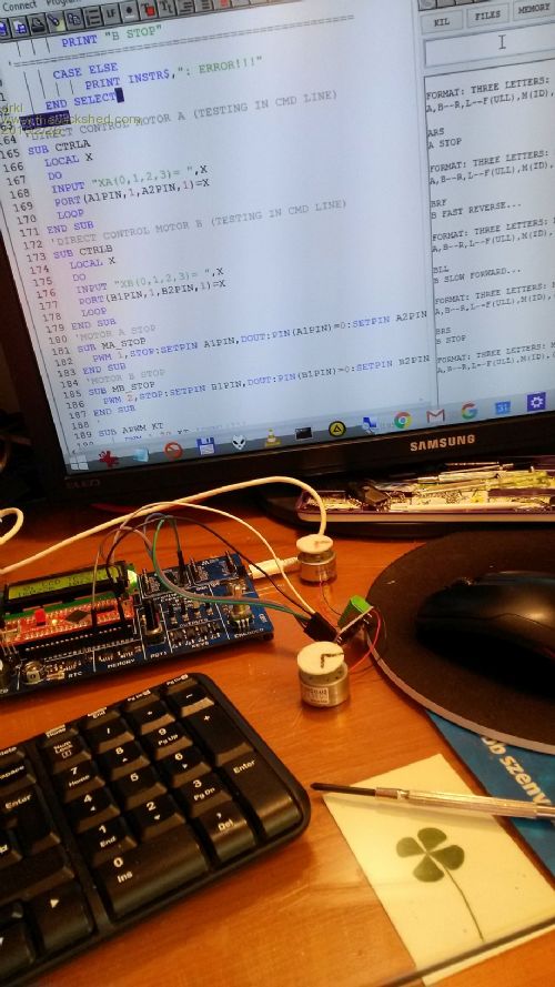

Hello
I purhased in ebay mot-ctrl
and here the test program:

Here is photo:

One hint about your ebay link : most ebay links are dead after 1-2 years , so i think put a screenshot png. from the ebay site with the item in the zip , so anybody can search later.
btw: whats the blue board ?
