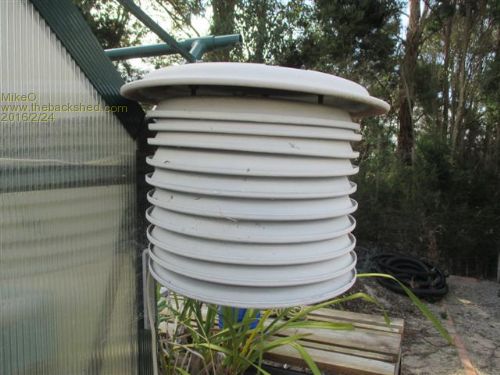

While your musing over your installation, I don't know if you had considered it but you don't want to put your temperature sensors up that pole in full sun (oops, sorry your in the UK, I feel I can comment I was born there) seriously if you want accurate temp readings you need to put the sensor in something like a Stevenson shield, about 2 mtr (6ft) of the ground. This is mine, made from garden planter plates, painted reflective white.
Mike
