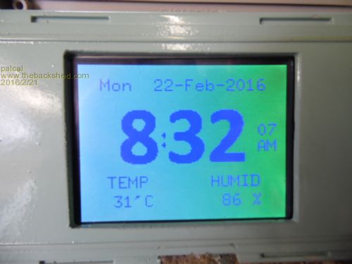

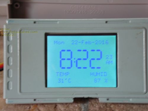

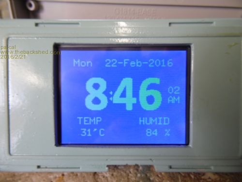

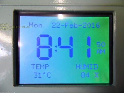

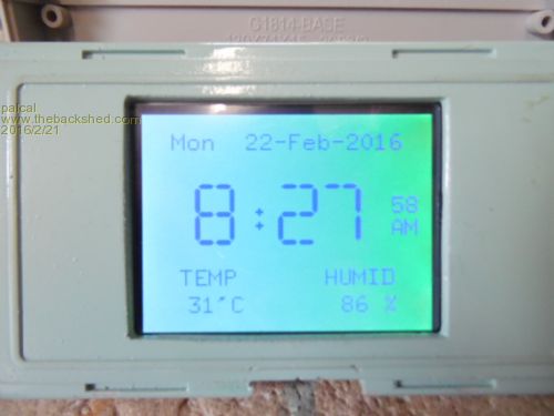

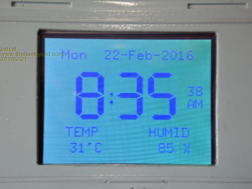

I am using the seven segment number font from here
Unfortunately the number 1 appears smaller than all the other numbers and does not look good. Is there anyone (maybe matherp) that could look at the file and make the 1 slightly larger.
Paul
edit. the 1 is also printed with the two right side segments which leaves a space between it and the previous number is it possible to move it to a mid position
the number 4 is also smaller
Hope this is not too much to ask.Edited by palcal 2016-02-22

I realise that but when the top segment is on the width of the segment makes that number larger. I also tried the 16 segment font but like the 7 segment one much better.

Try replace the data for the 1 with this and see what it looks like:

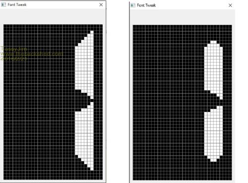

In the original code, each character is on one line. The comments are waaaaaaay over to the right. So replace the second data line with the stuff I posted above. You can edit what I posted back to just one line if you prefer. I just didn't want to post a code block that was some 1000+ characters wide.
Posted: 08:46pm 20 Feb 2016
I understand what you are asking for.
There are some 7 segment displays that use more of the corner.
I have started on a program to enable fonts to be tweaked (or created from scratch.
The image on the right is from SevenSegNumFont.c and the image on the left is a modified one.
Is that likely to be sufficient (while still complying with the seven segment purists) or would you like more tweaking.
I should be able to give you a modified font in a day or two. The full program will be a bit longer...

Thanks Jim that's getting there,can you retain the pyramid shape on top and bottom and fill in the middle a bit, also can you align the 1 in the centre of the grid.
The four also needs attention.

palcal
Joined: 12/10/2011
Posts: 2054
Posted: 01:30pm 21 Feb 2016
I have converted some fonts(switched to a 64 bit machine). These are some pics. not very clear though. As you can see by the time,temperature and humidity I live in the tropics in North Qld.
SixteenSegment 64x96
SixteenSegment 48x72
Calibribold.
SevenSegNumFont
SevenSegNumFont small 4 and 1
Calibribold colours reversed by touch screen
The screen can also be dimmed by touch for night time.
I have settled on Calibribold if my Grand Daughter agrees, the clock is for her
It is GPS by the way, with a DHT22 temp/humidity sensor.

paceman
Joined: 07/10/2011
Posts: 1329
Posted: 02:14am 22 Feb 2016
That looks great Paul - I like the SevenSegNumFont too. The GPO wall plate mounting idea works pretty well too (who was it did another one six months or so ago?) I was at Master's hardware here last weekend and they've got a big range of GPO wall plates that include several fancy modern looking designs, much more so than the standard white Bunnings HPM-type ones. Some are polished or brushed metal, some specially edged etc. - they'd make good mounting options too.
Are you going to release your code, and also how are you going to power it - wall wart?
