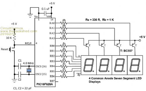

The LCD command's pin wigglings are not compatible with 7-segment displays, so you are unfortunately not going to be able to hook up the 7-segment LEDs and use the LCD command.
But driving 7 segment displays isn't too difficult.
Take a look at this to start:
http://www.electronics-tutorials.ws/blog/7-segment-display-tutorial.html
That covers the basics of one 7-seg display. To do three you set up the common connections to each 7-seg and share the segment lines. You can write code to cycle through and display each number (pattern) one at a time on each 7-seg display. Doing this fast enough makes it look like all three are lit at the same time, but you are really lighting them sequentially.
Herry

The PIC16F628A in the sample schematic is a microcontroller just as the MicroMite is. You can connect the 7-seg displays like the schematic shows, using pins from the MicroMite instead. You would have three displays rather than the 4 shown.
The schematic is for Common Anode displays. Similar schematics can be found for Common Anode 7-seg displays.
As a reference in the diagram above selecting one of the displays is done by selecting one common anode line (RA0 to RA3) and setting the RB0-6 lines to illuminate the correct pattern of LEDs. Each 7-seg is individually selected and the pattern for that number is output on the RA lines.
Again your lines on the uM wouldn't have the RA and RB designations, but would perform the same functions.Edited by CircuitGizmos 2016-02-20

If you want to drive your 7 segment displays directly, you need 7 pins for the segments and one pin for each digit as well as driving transistors for the digits.
In code, you have to convert each digit into 7 segment, output the data, turn the digit on briefly, turn it of and proceed to the next digit.
All this is relatively easy but you program will spend all it's time displaying the digits and this makes doing anything else tricky.

  Herry said   But my thinking is now along the lines of switching the anodes by the seven segments, but choosing the cathodes (per digit) using three pins. So a total of 10 would do it. How does that sound?
That is the method used in the second post of this thread.
It is called multiplexing and works well but you then have to continually switch each digit on in turn. This takes up processing time and makes any other things your program is doing more complex.
If you only want a 'one' in the first digit and no decimal point, you can use 7 + 7 + 2 = 16 pins without having to multiplex.

  Quote  If you only want a 'one' in the first digit and no decimal point, you can use 7 + 7 + 2 = 16 pins without having to multiplex.
Jim, for the 100's digit you only need one output pin. 7 + 7 + 1 = 15
GM
Posted: 08:50pm 20 Feb 2016
GM
Driving two segments directly from the 'mite is likely to overload the pin.
With low current devices that is OK but some will result in a dim 'one'
I was playing safe.
