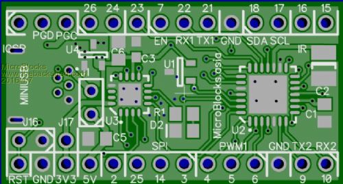

I have just finished the design of a uMite MX170 together with a USB-Serial-Programmer all on a pcb the size of a DIP-28/600mil.
I think (hope ) that this would be the simplest to use uMite because of its integrated USB to Serial chip. The uMite can also be programmed without the need of an external programmer.
It gets power through the USB.
The console of the uMite works right away, so you can start programming it with a terminal or MMEdit. If you want to update the uMite firmware it is just adding a jumper between pin 1 and 3 of the ICSP connector.
The ICSP is there in case the firmware of the USB-Serial needs to be updated and to bring out some pins of the PIC16F1455 that might be useful when you are hacking it. :)

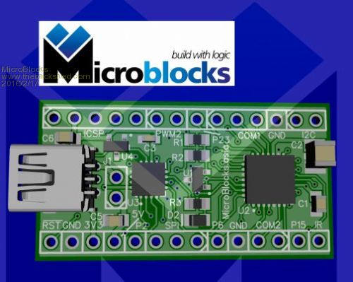

Schematic:

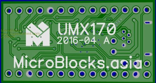

PCB:
The estimated price fully assembled will be around 14.95USD.
I expect these to be available beginning of march.
Comments/suggestions are welcome!

Posted: 02:52am 17 Feb 2016
I just send it to the PCB manufacturer.
Changed the layout a bit so all parts align. This will make placing them easier.
I also added a jumper to choose between USB power or external power.
These two pads can also be used to add a PTC, a diode, a switch or be used as two connections to easily measure the current being used.
Now wait....... Edited by MicroBlocks 2016-02-18

Posted: 05:38pm 09 Mar 2016
The pic can be loaded and programmed with the onboard USB/Serial converter. It also contains a programmer! (It is the small chip (pic16f1455) on the left in the picture)
The pcb's purpose is to be as user friendly as possible and work with readymade firmwares. For updating no other equipment is necessary as everything is done through the USB port.
When used as a uMite you loose two PWM pins as they are directly connected to the pic16f1455. For other uses it all depends on how you map the pins. The silkscreen is also as a uMite. Check the schematic for full details.
If you need the debugging capabilities of a PicKit3 then you can use one of the other PGD/PGC pins (there are three sets available). However the MCLR pin of the pic32 is not directly available, but if really needed can be accessed through a via or the supervisory chip.
I am also busy with a version in a DIP40 that carries a 44 pin MX170.

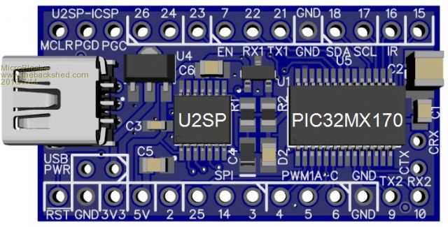

hi,
i really do like the concept - very Arduino Nano like. the one concern i have, however, is potential confusion over the mmbasic pin numbering not matching the module pin numbering.
have you considered connecting the PIC32 pins 1-1, 2-2, etc, while creating a seperate smaller 3-pin connector (PGC, PGD, MCLR only) for the PIC16's ICSP port? this could work well if you switched to a SSOP package for the PIC32, very much simplifying the routing.
rob :-)
addendum: can the PIC16 not hi-Z the PGC and PGD pins running to the PIC32 when not in ascii-ICSP mode? this would allow these pins to retain their normal mmbasic functions. Edited by robert.rozee 2016-03-11

Thanks for the comments. Something to consider as i would like it to be as easy to use as possible.
I am not sure what you mean with 'not hi-Z the PGC and PGD' pins.
When it is not in ascii-ICSP mode i switch those pins to an input (Tri-State) by setting the register TRISA bits to a 1.
I routed it so that pins that work together like COM/PWM/I2c are grouped and will be easier to wire up.
The QFN also has different pin numbers then a dip/ssop/soic so i used the Pxx on the silkscreen.
Mick also just remarked that the icsp for the picf1455 does not have to be a full icsp connector, making room for the other pins.
Great minds think alike. :)

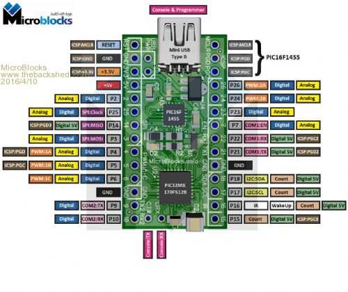

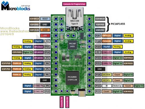

Today spent some time to make a reference 'card' for this module.
@Panky, I liked what you did with White Wizard's module and i used the same colors as it really enhances the clarity.
I would like to ask your permission to use that style.
Here is what i have now:
I also added the pin numbers that are used in MMBasic as on this module the pins are grouped per functionality.Edited by MicroBlocks 2016-04-06
