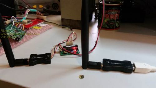

I have started to experiment with a radio telemetry link as used by many drones that are on the market.
This one is a 915 MHz system from Banggood.
I am surprised how easy it was to get going and the range is excellent (1.3km at 20% power).
Here is an image of the simple setup.
You will note the base station is USB but I would like to use an MM+ instead but have little idea how to wire up the USB and handle the USB comms in the MM+ if it's possible at all.

Interesting little units. What kind of output do you get on the USB base end?
IE: Does the computer see the base end of the link as a COM port or some kind of special device?
If it sees it as a COM port, then it is quite likely that inside the unit, there is some kind of TTL-USB converter chip. Your best bet would be to bypass that chip, so that you can intercept the data coming out of the link. That idea won't work, if the device ID's itself to the computer as some kind of special USB device.
As to the MM being able to act as a USB host for the USB base unit, that is highly unlikely due to the amount of background work that would have to go on, to allow the MM to talk to the USB interface - I don't ever see that happening on any of the current MM models. I might be wrong, but......

  Quote  IE: Does the computer see the base end of the link as a COM port or some kind of special device?
It is seen as a USB serial port. Manufacturer FTDI

It's probably the FTDI USB-serial chip then. You could tap into the TTL serial where it goes into the FTDI chip, if you wanted to do a module hack.
Otherwise, the modules Rob linked to would be worth a try - I am about to play with them myself.
