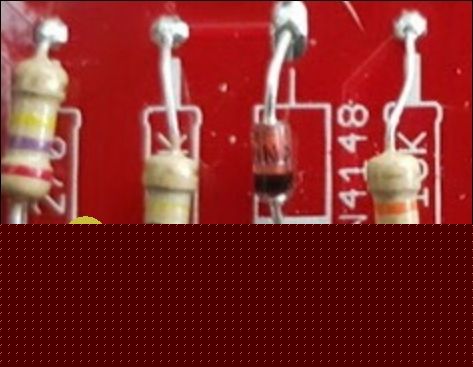

The 1N4148 diode in the photo may not be soldered on the bottom leg. I don't have a circuit so I have no idea what effect that may have.

Posted: 02:48am 04 Feb 2016
it also looks like you have a 270k resistor in series with the output to the clock module (red-purple-yellow). this should be 270 ohm (red-yellow-brown).
the 270k resistor will ensure the hands can not move!
rob :-)Edited by robert.rozee 2016-02-05

The diode although it looks not soldered, is soldered underneath the board, however I will redo it when I get up in the morning
However it is definitely working as the max756 is putting out the correct voltages.
The resistor I actually measured it with a meter and it's 269 ohm
I also measured the voltage coming out of pins 17 and 18 of the pic, but am getting no voltage output
I "think" it's because the pins are only high for 40-56 mS and my meter might not be able to detect it, and I don't have an oscilloscope to check with

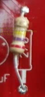

  lew247 said   [...]The resistor I actually measured it with a meter and it's 269 ohm
Are we talking about this resistor? That's astonishing!
Are you a b s o l u t e l y sure?
In addition I would inspect all solder points. Good luck!
Michael Edited by twofingers 2016-02-05
Posted: 06:05pm 04 Feb 2016
just for my own piece of mind, could you possibly check the resistor again? making sure that the clock module is not plugged in when you do the check.
that multiplier band really looks like it is yellow, and not brown.
rob :-)

  robert.rozee said   just for my own piece of mind, could you possibly check the resistor again? making sure that the clock module is not plugged in when you do the check.
rob :-)
rob
In the picture below I have sampled the colour bands on each resistor with a colour picker. I then pasted each sample onto the image. You can see the effect. The band on the left hand resistor did vary a bit from light yellow to a mustard colour depending where the sample was.
bob
edit: I updated the image to show the yellow range.
Edited by BobD 2016-02-06
