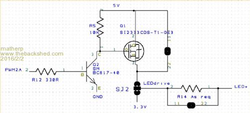

I now use this on all my PCBs:
Gives complete flexibility on the PCB allowing fixed 3.3V, fixed 5V or PWM 5V depending on the display, with or without dropper resistor. Just populate the bits you need for any specific application and jumper the requisite shorting links with solder.
Posted: 02:58am 02 Feb 2016
you could probably make R12 a much higher value if you wished, 330r will give a base current of (3.3-0.6)/330 = 8mA when turned on. 3k3 or even 10k should work equally well.
rob :-)

palcal
Joined: 12/10/2011
Posts: 2054
Posted: 10:30pm 02 Feb 2016
I went with Jim's circuit as it was the easiest and it works fine.
