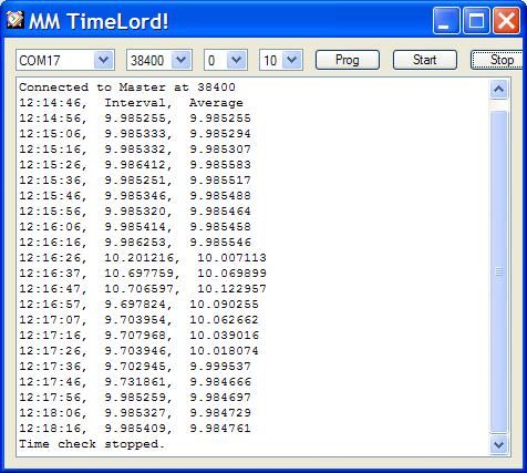

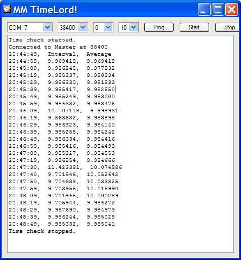

Jim - just gave this a go on the old XP system and got the data below connected to Mik's SMD Backpack running V5.1. It was connected via USB and the FTDI chip on the backpack.
If you look down the data to time 20:47:30 you can see a bad result (big Interval/Average difference compared to most of the others). That came from me adjusting the size of the XP window as it was running. There are a few directly below it too that are anomolous which were caused by me leaving the cursor on the box edge - it went back to normal differences after I moved the cursor. Looks like you can't play with your PC when you're collecting your data.
I looked at my differences too compared to your results and it's obvious mine has a poor precision. I wonder if that's because of my old slow XP system, or something else?

@Greg,
I was expecting to see some jitter but not as bad as yours.
TimeLord sets an interrupt to trigger just before the data is due to arrive.
Windows puts its interrupts into a que and gets around to them when it gets time. In your case it's taking over one second to check the serial port.
For best results, no playing games or surfing the net while doing the test.
After the strange results (slow) we were getting with FTDI, I would be interested to see a comparison with a different chip and your PC.

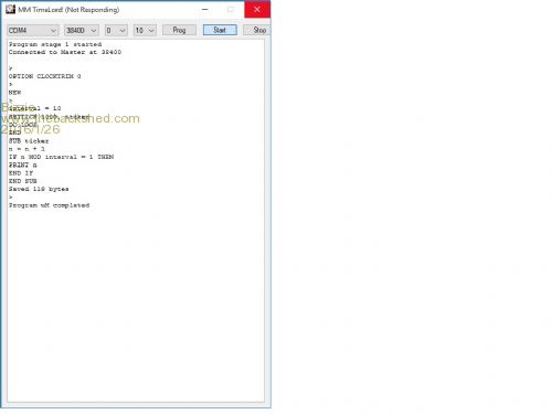

I get nothing! If I start TimeLord and click [program], then [start] this is all I get :-
This is after at least a minutes wait.
Rob
Rob White

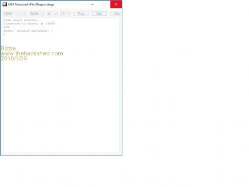

Posted: 01:35pm 26 Jan 2016
Jim,
Do not get much further :-
Sorry image is poor, can not copy text as locked! I need to find a better way than Alt Print screen and paint.
Not sure why the program did not show program - perhaps here's my problem!
I have seen the tilder character and the message when ever I start TT with the MM already powered, I have always ignored this!
I am using the freetronics usb-serial adapter chip is ATmega16u2 MCU

Posted: 03:03pm 26 Jan 2016
I don't have one of your adapters so not able to test but we are making progress.
Another version for you to try.
2016-01-27_010132_MMTimeLord.zip
You can highlight the text in the output window and use ctrl-C to copy it.
That makes it easier to read.

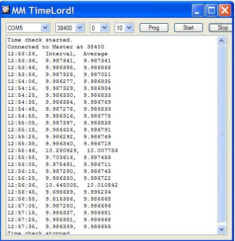

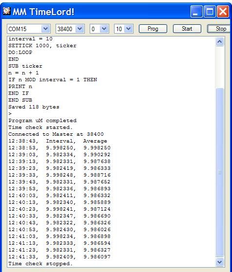

OK, sure looks like FTDI (or their clones??) are a problem. Just repeated it on Mik's MUP with network disconnected (so no external interrupts?) and with MUP's on-board FTDI and got this below. Note the jump to 10 secs and bad results when I fiddled with window size again. It also takes a long time to come back to 'normal' - I wasn't fiddling after the first two 10 sec bad results.
Then tried a standalone FTDI converter on a DIP 170 and got this. Pretty much the same crappy results - it 'looks' better because I didn't fiddle with the window size.
Then tried a PROLIFIC converter (in a DKU-5 moulded cable - but the device manager does say it's Prolific), and got this.
One hell of a lot better! I had another window size 'fidddle' at 55:46 and 56:35 to see if that still affected it - and it does.

Posted: 06:11pm 26 Jan 2016
@Greg,
Any time you move or alter the program window, it will be too busy to check it's timer.
If you slowly move the window around, the timer will never trigger, no matter what the PC is. There is nothing I can do about it (except learn how to do multithreaded applications).
Playing with other windows should not have much effect.
Different drivers for the various chipsets do seem to have different delays. I expect that FTDI are spending too much time checking for fakes!

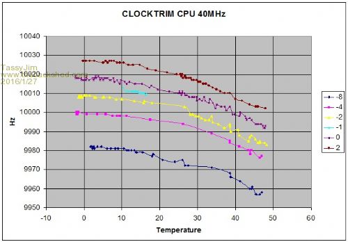

When we first had CLOCKTRIM added to MMBasic, I did a few tests.

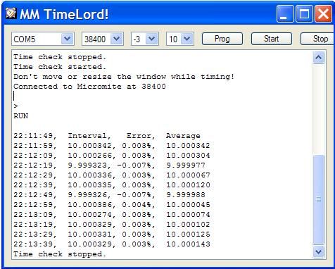

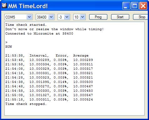

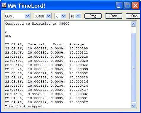

It's very practical as it is Rob. With a zero clocktrim (CT) my old system gives a difference of -0.014% and with CT at -3 gives 0.003%. It's stable to the 3rd dec.pl. difference for most 10sec. intervals (maybe Jim should make that 4 dec.pl.) but occasionally gives a kick, presumably due to something happening on the laptop. Certainly if you fiddle with the mouse or keyboard it changes.
The runs below were all done at my 'best' setting (CT=-3) using the Prolific converter and no fiddling with mouse or keyboard. The first one had the browser open and network connected, for the second one I closed the browser and for the third I also disconnected the network; nothing else was running for all of them. They're pretty small data sets but it looks like the browser creates the occasional kick. I checked the task manager to see if anything obvious was happening with that 'noise' period but nothing was obvious.
In any case, even with the occasional 'noise' kick it's obvious which is the best CT setting.

When I did the temperature runs, I used a maximite to measure the frequency being generated by the micromite. That worked well but needed extra wiring.
We are still only using an oscillator of unknown precision (in the PC) for our reference, so I am happy with the result. I need to compare a few different PC's to see what variation I get but don't want to get too hung up on the results.
