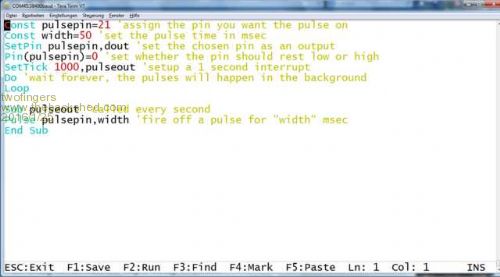

I noticed this on both MM 5.0 on a MX170 with serial connection to Tera Term (VT100 emulation) and just now with MM+ 5.1 on a SnadPIC using USB serial port and Tera Term (VT100).
Today, with MM+ on SnadPIC connected through USB at 38400, if I enter "option colourcode on" and go into edit, the program displays as expected with proper highlighting except there are no function keys at the bottom. ESC of F1 to exit gives ma a blank screen. If I enter "option colourcode off" at the blank screen and go back into edit, the function keys appear at the bottom and when I exit, the text displays as expected.

System:
MM 5.1 on a MX170, Baudrate 38400.
Win7 and Tera Term 4.85 set for VT100 emulation.
MichaelEdited by twofingers 2016-01-26

My guess is that the background colour the same as the function key text. Not sure about Teraterm but in PuTTY I wanted a black background and had to change the black text to actually be white (or another contrasting colour).
Anthony.

NEVERMIND, I get it!!
I'm of the age where TERMINALS have BLACK backgrounds!!
My Tera Term *HAD* a black background...now it is the correct colOUr!!
