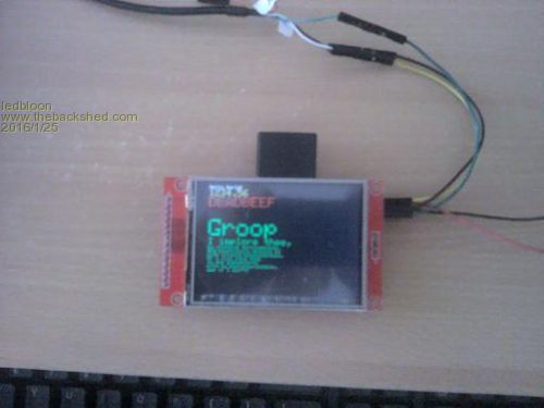

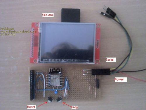

Maybe of some interest to somebody...ILI9341 backpack ESP
ESP-12F programmed using Arduino IDE v1.6.7 and the ESP v2.0.0 platform package.

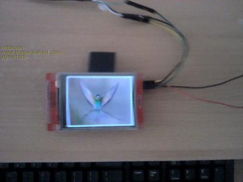

The ILI9341 LCD display programmed with Adafruit-ILI9341 & Adafruit-GFX libraries (although I had to make many fixes in the ILI9341 for it to work). Access to the SDCard ok, one test program draws a 24 bit Windows bitmap file from the SDCard.
Usual graphics with text, lines, boxes, circles & triangles. Works quite niceley.
Another (simple) test program, connect ESP to local LAN, then send commands from PC via telnet to draw text & graphics.
Next step, connect to internet to gather info to display...

Haven't tried touch yet. The touch screen on the display in the photos was broken in transit here, but will swap with the one on the uMite, at some point, and get it working.
Will just be playing with display of info off the internet for awhile and see what appeals (time/date, weather, stocks?, other...)

Also, waiting on the esp32 to start shipping, before I think about a pcb.
