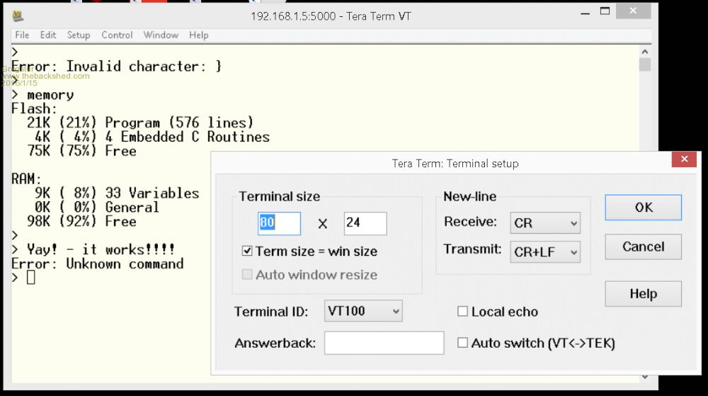

Please refer to this thread for details on an old networking issue, which we SOLVED for that platform, but now I can't make the MM+ respond to commands.
- Network connection IS established between network and serial console on MM+
- MM+ DOES echo commands, but ONLY after you press [ENTER]
- You can type whatever you like and [ENTER], and the MM+ does nothing
- Keystrokes are NOT echoed while typing at the > prompt.
- Keystrokes show up as complete words when you press [ENTER]

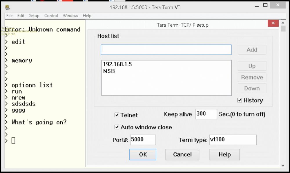

This is the result of the network connection and attempts to talk to it:
# IP address is correct, so is port number.
# TT is set to vt100 mode
# Baudrate of console is 38k4, but have tried lowering to 9600
Slower baudrate of 9600, and changing that in the network module config also does not help - it is exactly the same.
I don't get what the hell I am doing wrong......
I will now try connecting a different device to the network module to see what happens.

UPDATE
I have fixed the no-echo thing by changing Line-At-A-Time to off.
The MM+ is now echoing back each keypress, but [ENTER] still does nothing and no commands are executed.

Posted: 12:20am 15 Jan 2016
change teraterm to send cr and lf
jim
Posts: 10109
Posted: 01:02am 15 Jan 2016
@ Jim - You're a star!!!
That was what was stopping it!!!!!
Thank you, thank you, thank you.
